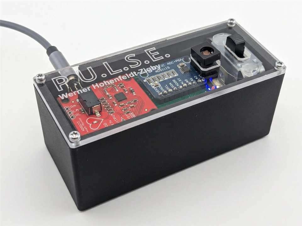

Finishing the P.U.L.S.E. ECG System
Portable Unit for Live Signal Electrocardiography
A bit of history
Ever since I started getting into electronics, I have had this idea of building my own ECG device. Something that could actually show heart signals in real time instead of just reading about them.
Like most projects, it started simple. I picked up an AD8232 module, wired it up, and after some trial and error, I managed to get a signal. Seeing that first noisy waveform was honestly a pretty big moment.

The first major change was adding an ADC. Instead of relying on rough readings, I used an ADS1115 to get a stable, high-resolution signal.
From there, the system started to take shape:
  • ECG module → ADC
  • ADC → Raspberry Pi Zero
  • Raspberry Pi → processing + interface
Using a Raspberry Pi made a big difference compared to the original setup. It meant I could handle acquisition, processing, and display all in one place.

Powering the system
One thing the original version completely lacked was portability.
To fix that, I powered the system using an Adafruit PowerBoost 1000 paired with a 2000mAh LiPo battery.
This setup:
  • Boosts the battery voltage to a stable 5V
  • Allows the Raspberry Pi and peripherals to run reliably
  • Adds built-in charging over USB
In practice, this means the entire system can run:
  • Without being plugged into the wall
  • As a fully portable unit
  • For extended sessions, depending on load
This was a small addition, but it made a big difference in turning the project into something that actually feels like a device instead of a bench setup.

Assembly
Putting everything together this time was much smoother than the first attempt.
The system consists of:
  • ECG sensor
  • ADC module
  • Supporting wiring / PCB
  • Battery + power system
Compared to the original version:
  • Fewer loose wires
  • More stable connections
  • Much easier to debug
It still took some trial and error (especially with signal noise), but overall it felt like assembling a system instead of experimenting.
Powering it up
The first proper test was opening the web interface and seeing if everything worked together.
And this time, it actually did.
  • The ECG signal shows up in real time
  • BPM updates correctly
  • Detection flags appear when expected
  • The interface works on both desktop and mobile
  • Reports generate without issues
It’s a pretty big difference compared to the original version, where just getting a readable signal was already a challenge.
