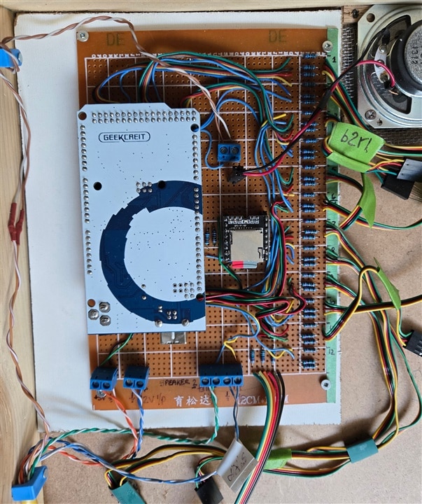

I completed the Fireworks Simulation with Optical Fibre Cable project in 2021. During a model railroad showing in 2024, I discovered the sound was not working. It has been sitting in the shop waiting for repairs ever since. The project was made on perf-board using point-to-point wiring. The code was one of my early dabbling in Arduino.
I made a number of attempts to find the sound problem. I tried replacing components, adding some filter capacitors and probing with a VOM. No luck. The condition of the board had me rethinking the repair. The project perf board was supposed to be a prototype that made it to production. Maybe I could do better.

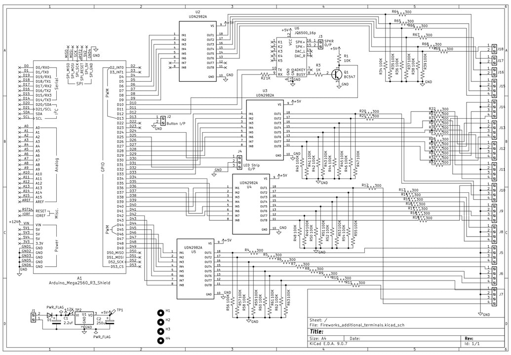

Unfortunately, I didn’t have any documentation for the project, only a broken prototype. Using the Project 14 repository as a guide, I pieced together the details of the project.
After creating a schematic in KiCAD (the drawing is the final layout), I set about making some changes. Readers may recall that in February, I had made a post looking for an LED driver.
Besides the sound not working, the animation would intermittently hang on boot-up. The LEDs were driven from Mega outputs with no buffering. I suspected boot-up issues may stem from overloading the Arduino. Let’s fix the issue in the PCB with some LED drivers. I also no longer used the DFModule for projects that needed sound. The JQ6500 was its replacement. Both modifications to the circuit plus code updates would be necessary. Did I mention the fix project kept getting bigger!
I constructed a breadboard layout for the new design. This allowed me to confirm that new pinout and driver circuit for the LEDs I planned to use would actually work. The original designed used pins that are assigned functions. The new pin mapping avoid many of the traditional assigned pins.
This breadboard set up sat on my bench for weeks! I kept wanted to move it to free up space. I knew if I moved it, the fix would not happen. The finished PCB languished in JLCPCB order purgatory because I forgot to place the order. I uploaded all the drawings to the website but a squirrel pulled me away and I never dropped the order. That "miss" proved beneficial. I came across some errors on the PCB while looking to answer the E14 call for a Spring Cleaning Project.

I had discovered during my review of the KiCAD drawings that I had oriented some diodes incorrectly. Also the PCB connections for the LEDs were poorly positioned. I had also forgotten silk-screen the labeling. The board review was extensive. Ouch! The power supply terminal polarity labels were backwards. After implementing the fixes, I crossed my fingers and placed the PCB order. The PCB’s arrived the last week of April.

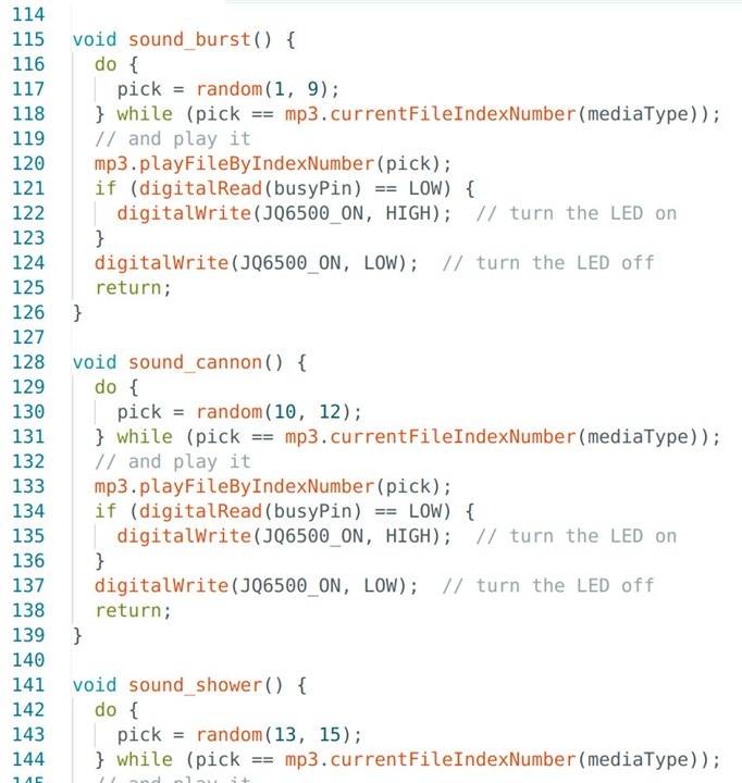

I stripped the original code of all pin numbers and the DFModule code workings to have a code starting point. I then coded the pins for the LED arrays with new pin numbers. The LED light pattern worked according to design on the first test!
I had on foolscap paper created a mapping of the individual pin numbers to LED array names. I created the map when I first started on the schematic. Each version of the mapping showed the changes in pin assignments. That one document made pin assignment in the code a breeze to make. Thank a holy deity for documentation.
To fill Void setup in the Arduino code, I cut-and-pasted working JQ6500 module code I had used in another project. I then defined three subroutines for each of the three different sound sequences. Cannon, burst and shower are three sounds in the animation. Each can randomly select a sound file from a list.

The installation of the new PCB was a breeze. Recall I had no documentation so the first step was to ensure I had all connections labeled. I removed the old perf board and mounted the new PCB. The screw terminal connections worked as planned. The speaker wire had to be extended, the PCB connection was in a different place than the perf board. The video is the proof that the animation is back to working.

    36 with drivers and 2 straight off the Mega makes makes for 38 LED's. At each drawing 20ma that puts the LM7805 at 3/4 of it rated current. The fireworks never lights all LED's at the same time. I would consider putting a heat sink on the regulator if the demand was higher in another application.
    The LED are buffered by a crude driver circuit. A suggestion to use a multiplexer was interesting and would simplify the drawing. I'm not strong with coding so that become a challenge. I'm still looking at the idea.
