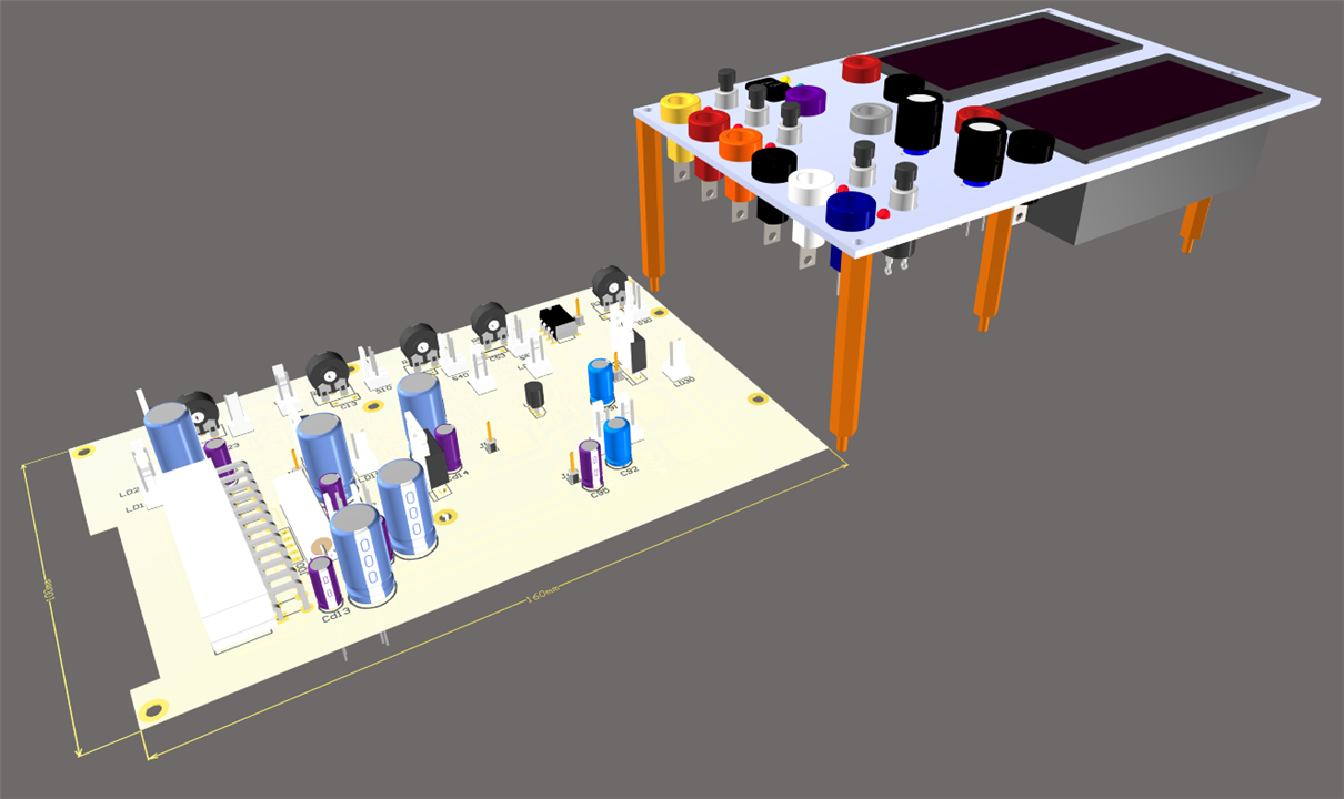

Hello all,
Before engaging into this challenge, I'm writing this message to "fish for ideas" about that project of mine that has been sitting in parts on my shelf for more than 14 years.
Basically, it's a classic ATX to lab supply project, and in my case, I have the parts in a variety of bags, one that has even crumpled to bits all by itself.
I have done quite a few Spice simulations, created the project in my favorite CAD software of that time and even went as far as using 3D models for everything to get this nice rendering:

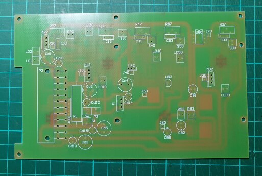

What stopped me in my tracks back then were two issues:
  1. How to create the front panel with precise cuts and nice labels
  2. How to create the 100x160mm (euro size?) single sided PCB
The first part, I can now do it by printing the plate with my 3D printer and so get the precise cutouts. Getting nice labels should be doable with sticker printing services, or maybe just a transparent sheet on the inkjet printer.
But it's the second part that's giving me a hard time as it seems not many services provide such size options at an affordable rate, for delivery in France. However, I must admit that I'm not really good at finding those things.
Note that the cutout in the board is there for a nice 3D rendering but does not need to be present at all on the files I would send to a pcb service.
Would any of you have suggestions?

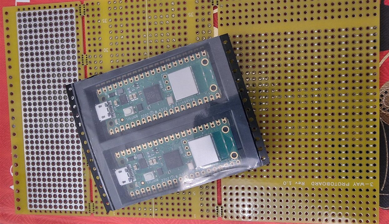

    Ordinarily I just accept there may be wasted boards, since the minimum quantity is 5 PCBs. However, if you want to make the most of the purchase, then you could re-do the PCB so that it's more general-purpose, for instance, create a PCB that has the ATX socket footprint (and any other unusual footprints), but the rest could be just a matrix of holes, so that you need to do point-to-point wiring on the underside to make the power supply. Then you could use the remainder boards for other projects too.
    The photo below shows a 100x160mm board from the above-mentioned manufacturer (discussed here, A Three-Way Prototyping Board for Awkward Through-Hole Components ). I ordered 10 of these boards, so even though it will be overkill for a small project, I will dedicate one for a Pi Pico project (and use the large space to put things like battery holder, switches, maybe even a display.

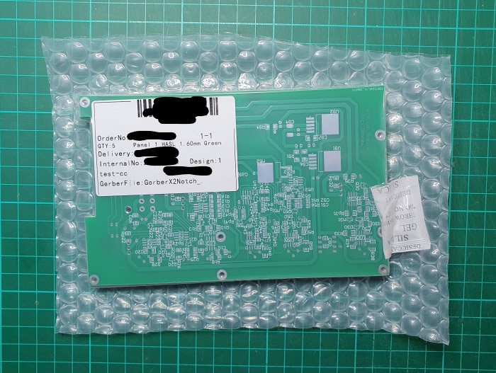

    Ok, I just placed the order for the minimal amount of 5 boards with the following details:
    PCB: 6.96€
    Shipping costs: 7.25€
    Customs and taxes: 2.85€
    So in total, it's 17.06€ which I find totally acceptable for such a PCB that is way out what I can do at home.
    Thanks for your answers, it helped a lot
  • obones
    obones over 1 year ago in reply to obones
    They have arrived !
    The holes seem a bit too narrow for quite a few components, but it shouldn't be too hard to widen then a bit, without damaging the neighboring tracks.
  • colporteur
    colporteur over 1 year ago in reply to obones
    I've done a number of boards without hole issues. I take that back. I've had issues when I spec my own hole size for mounting holes.
    Have you identified what caused you hole issue?

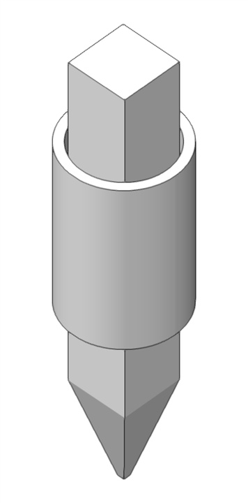

    shabaz over 1 year ago in reply to colporteur
    I'm not suggesting this is what obones  is experiencing, but I have occasionally seen a newcomer mistake is to take the dimensions off of the engineering drawing for the part, and not realize that the component leads have a rectangular cross-section rather than round, and directly using the dimension on the drawing plus a small arbitrary increase for tolerance, to become the diameter of the hole (i.e. "square peg in round hole" type of issue).
  • obones
    obones over 1 year ago in reply to colporteur
    Well, it's a rookie mistake in that I'm used to take the "default" footprint as provided by the CAD package and even though the lead spacing is good, their size is not appropriate for the real life components I'll be using.
    But that's a lesson learned here, always check the pad sizes with a real component at end, most of those I'll be using here do not have a readily available datasheet anyway.
