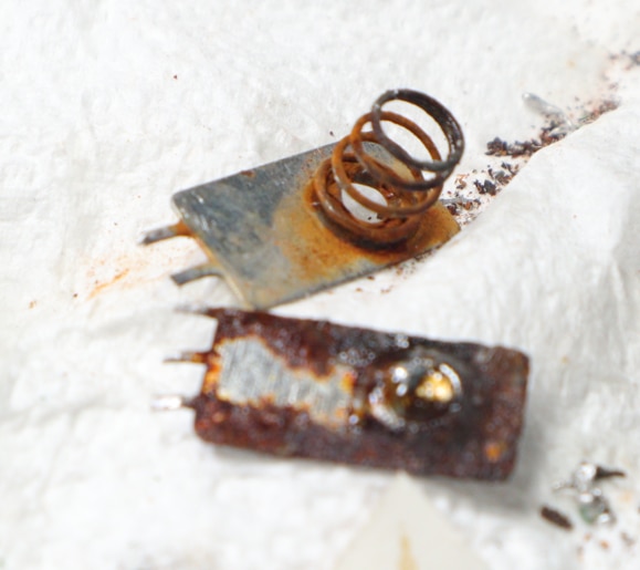

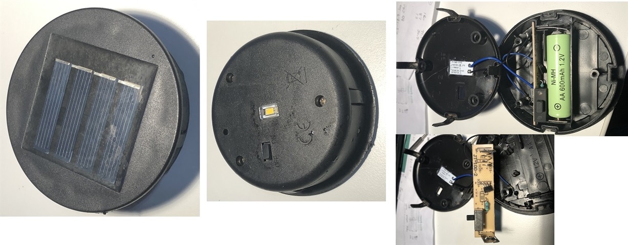

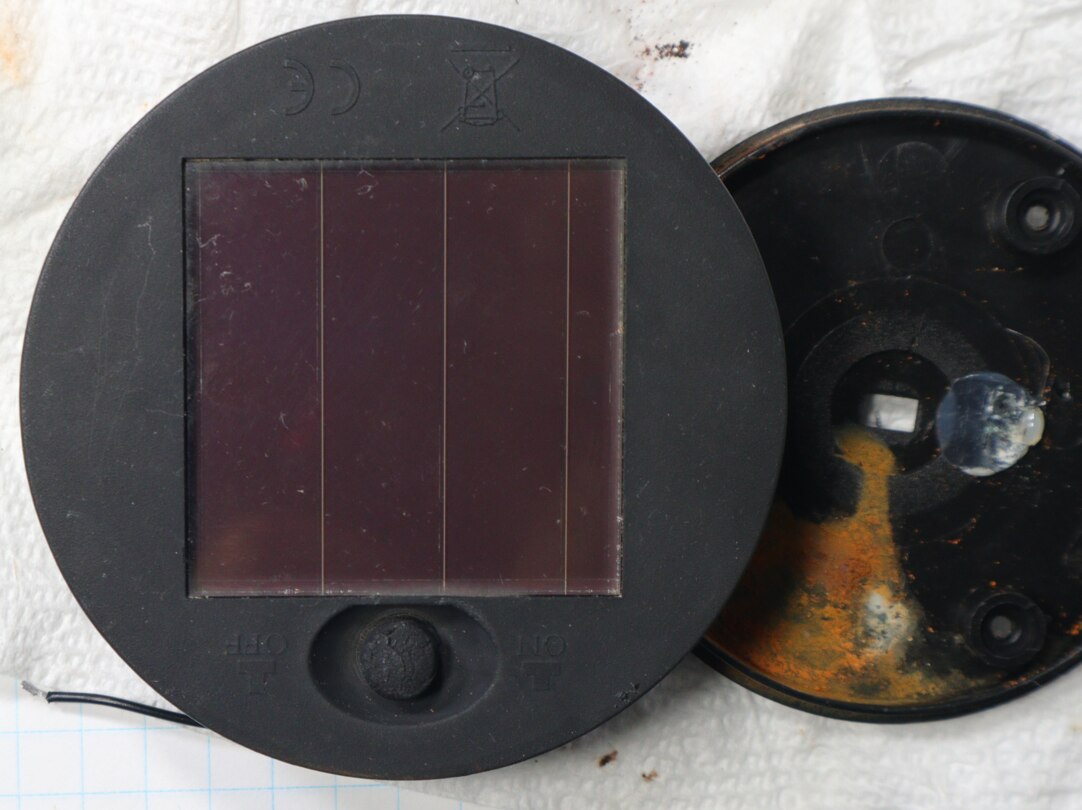

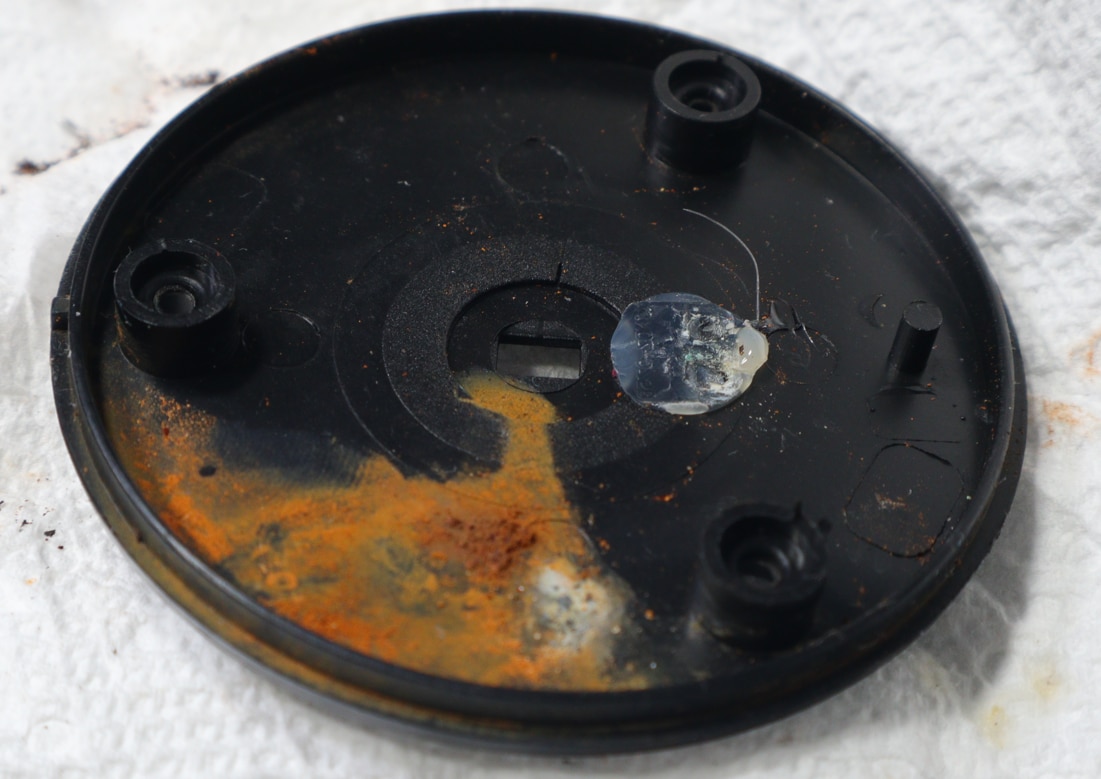

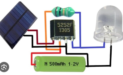

One of the solar garden lights was in desperate need of some spring cleaning.
The top rubber button cover had rotted over time and began to leak when it rains.
Almost all of the internals were in dire straits.
Before taking everything apart, I tried tinning the batery contacts with fresh solder to see if that was the only issue, it was not.

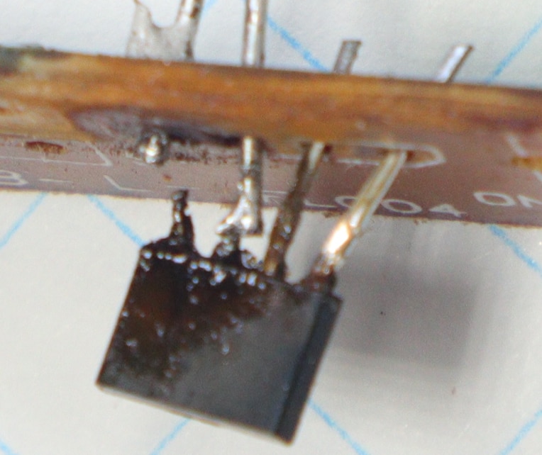

Even the solar charge/led driver IC (qx5252) had two of its leads corrode away.
I made a brief attempt to solder to what was left of the lead frame with limited success. Eventually with some cleaning and scraping I was able to make a connection.
I also tossed something together with an ME2108 module.
When the solar panel stops sourcing charge current Q1 turns on lightly. As the output of the me2108 module rises M1 starts to conduct and provide a “low” resistance to ground. Q2 pulls the gate of m1 low, thus disabling the boost module, should the solar panel starts sourcing current before the battery dies.
Surprisingly the solar panel was still functional. I have had a few lights where panel connections corrode away. Many of these cheap lights don't put much effort into waterproofing the solar connections.

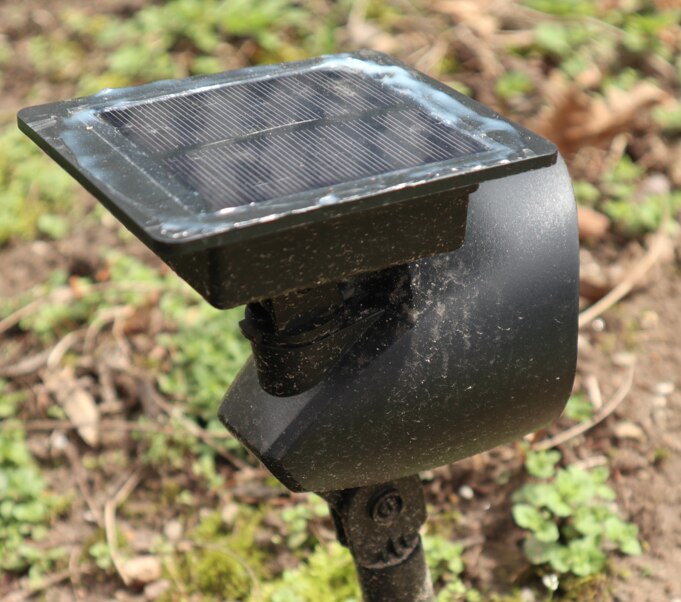

    Nice job scottiebabe. For spring clean, I took apart old failed ultrasonic deer repellent modules, and have similar observations. The solar panels were fine,  the batteries were still in decent shape. The enclosures let in bugs and moisture , causing corrosion on component leads.
    I couldn't identify some of the ICs on the control board, but experience hints the PIR sensor dont last more than 3-4 years at best.
    Hats off to you for finding a nice module to recover and recycle the lights.

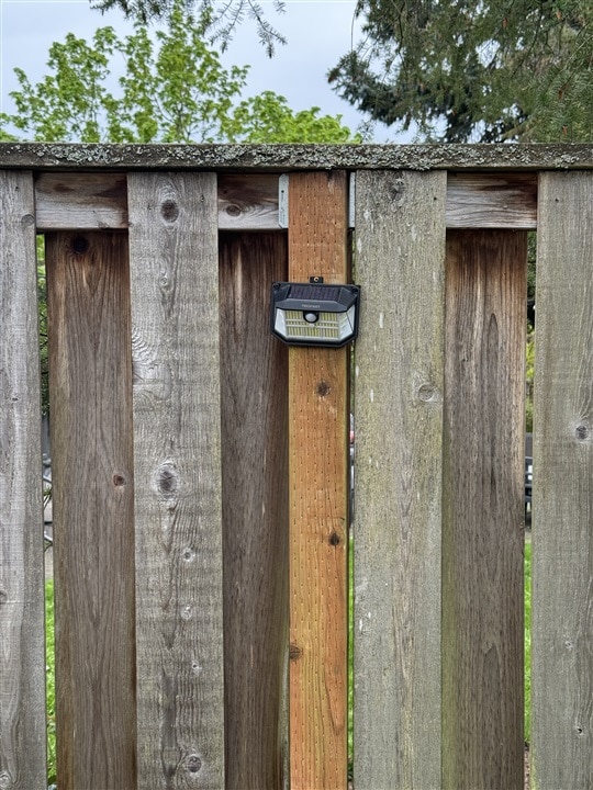

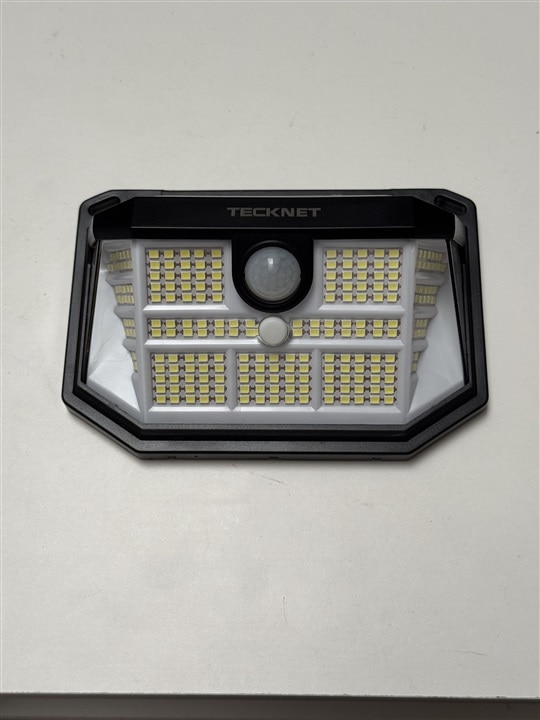

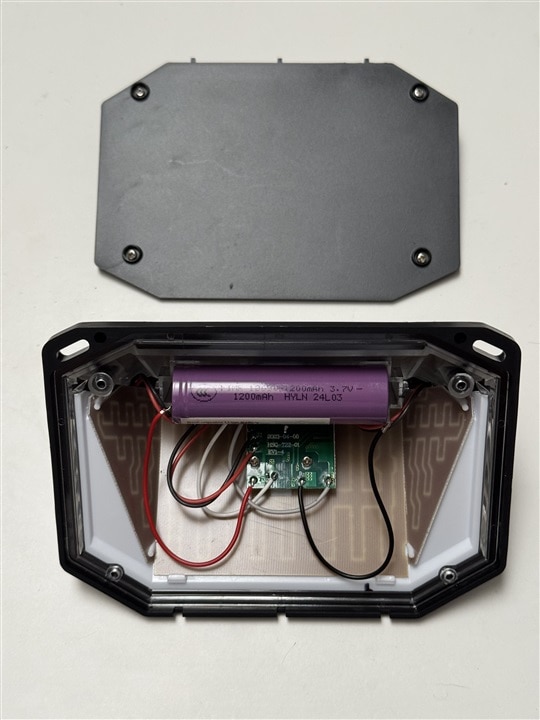

    Last summer when the coyotes were active, I put out solar fence lights to detect critters inside my fenced backyard.  They have been working reliably but maybe I should open them up and check for corrosion.
    They were pretty clean before I started.  I'll get some after pics tomorrow.

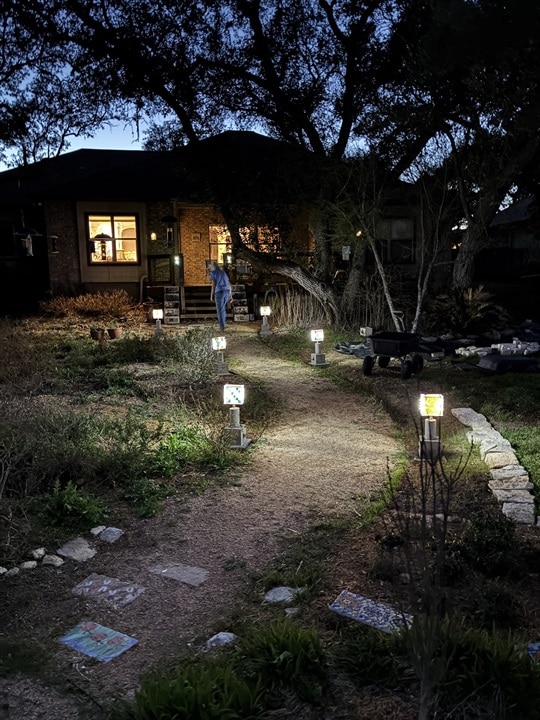

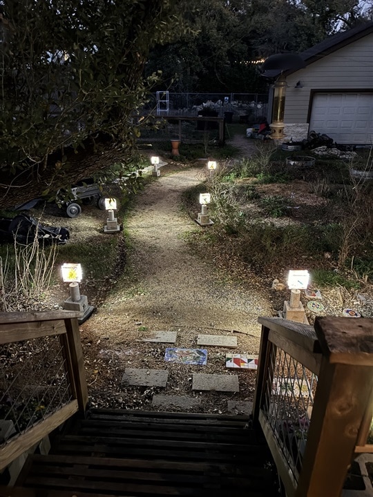

    Joy  Yes.  We have the hummingbirds... and flamingos... and hummingbirds on their own stakes... and angels.  We got a lot of solar lights. Relaxed

    I have these lights every few feet on my deck and in the backyard. For me, they last amazingly long, 7-10 years. Failure mode seems to be the plastic overtop the solar panels degrades and greatly reduces the charge current , and the really old ones will have the plastic eventually crack from uv exposure.
    If they are working well, opening them up to check for corrosion may invite premature leaks. Id wait for them them to start acting up before looking for problems.
