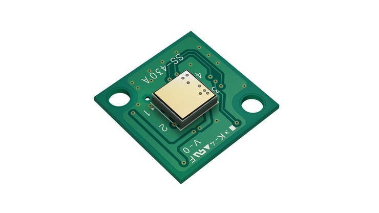

Step 1: Getting Started with Pyroelectric Proximity Infrared Sensors (Content from KEMET)
KEMET Electronics Pyroelectric Proximity Infrared Sensor Modules use the pyroelectric proximity effect of ceramic by absorbing infrared rays emitted from the human body. This detects the natural infrared signature produced by humans. It can detect infrared rays without using lenses, allowing a detection distance up to 2 meters. By adding a KEMET proprietary lens, the detection distance can be further improved up to 5 meters. The lens is available in three different colors, to enable some design flexibility. KEMET Electronics Pyroelectric Proximity Sensor Modules in the module solution are even easier to install with the driving being already included in the package, making it just "plug and sense".
KEMET Pyro Sensor
KEMET Pyro Sensor
FEATURES
  • Reflow capable SMD configuration
  • Lens not required
  • Wide view angle up to ±60°
  • Detection possible through glass or resin
  • Low power consumption, down in the μA range
  • Excellent radio wave performance in a high-frequency band
  • Compact and low profile (5.0 x 4.8 x 1.7mm)
  • Human presence detection sensing for energy-saving functions in a variety of applications

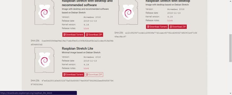

Step 2: Burn Raspbian to the SD card
Raspbian is the Linux distribution of choice running on the Raspberry Pi. In this guide, we will be using the Lite version, but the Desktop version (which comes with a graphical environment) can be used as well.
  • Download Etcher and install it.
  • Connect an SD card reader with the SD card inside.
  • Open Etcher and select from your hard drive the Raspberry Pi .img or .zip file you wish to write to the SD card.
  • Select the SD card you wish to write your image to.
  • Review your selections and click 'Flash!' to begin writing data to the SD card
Download Raspbian Stretch Lite

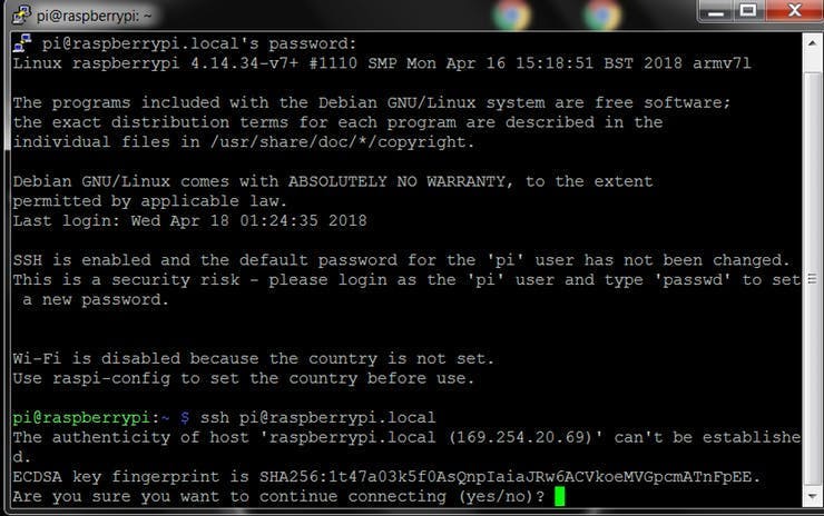

Connect the device to your network
  • Enable SSH access by adding empty file ssh, again placed at the root of the boot volume on your SD card.
  • Insert the SD card into the Raspberry Pi. It will boot in roughly 20 seconds. You should now have SSH access to your Raspberry Pi. By default, its hostname will be raspberrypi.local.
     On your computer, open a terminal window and type the following:ssh pi@raspberrypi.local. The default password is raspberryimage

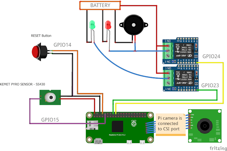

The Block Diagram of this circuit is given below.
Block Diagram
Block Diagram

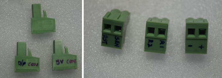

To make these connections, I've used separate connectors for power, relay output, and sensor input. Each connector is soldered to the Raspberry Pi as shown below.
Connector
     Connector

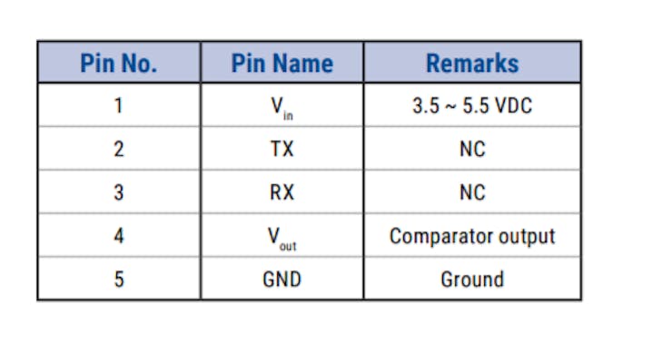

The Pinout of the SS-430 pyroelectric sensor is given below
SS-430 pinoutSS-430 pinout
The connection is made as shown below.
SS-430 ---> Raspberry Pi
Vcc (1) ---> +5V
Signal (4) ---> GPIO15
GND (5)---> GND

RELAY BOARD
We connect the Buzzer and an Emergency light using a relay circuit to the GPIO pins 23 & 24 of the Raspberry Pi.RELAY DRIVE CIRCUIT
     RELAY DRIVE CIRCUIT
The Power Supply is used to deliver the power for the Status Light, Emergency Light, and the Alarm.Power Supply
     Power Supply
The Industrial grade Light Indicators and Buzzer are used to show the status and alert signal to the security (user).
Relay Board ---> Raspberry Pi
Vcc ---> +5V
IN1 (Secure Light)---> GPIO23
IN2 (AlertLight & Buzzer) ---> GPIO24
GND ---> GND
The Industrial grade Light Indicators and Buzzer are connected to the GPIOs of the Raspberry Pi.Sensor ConnectionSensor Connection
PUSH BUTTON
The Emergency reset button is connected to the GPIO pin 14 of the Raspberry Pi.Push ButtonPush Button
Arcade Button connected to raspberry piArcade Button connected to raspberry pi
The emergency button is used to turn off the alert manually by pressing it once.
The Overall connection is shown below.
Overall ConnectionOverall Connection

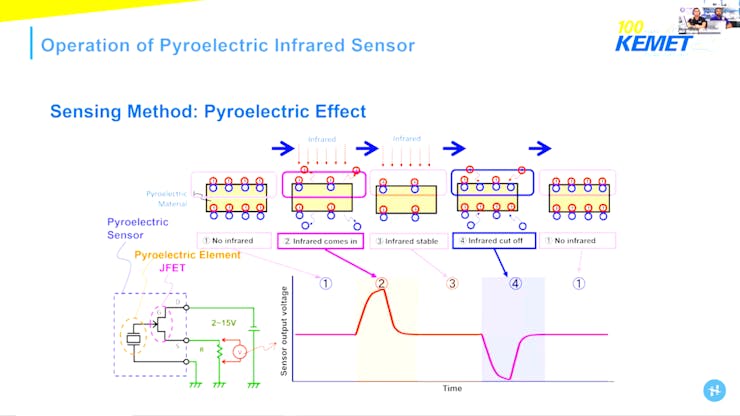

Although the above code worked, I had a few false triggering. After going through the documentation from KEMET, The SS-430 produces two output pulses of 200msec per detection. This can be interpreted by the Raspberry pi using the following code:
Timing Diagram from the webinar

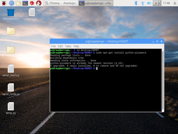

The picamera library is installed using the following command
sudo apt-get install python-picamera
installing picamera lib

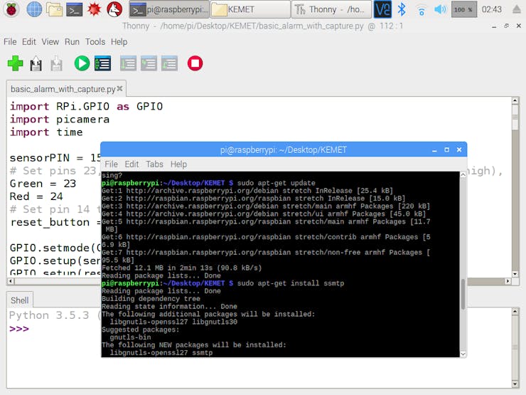

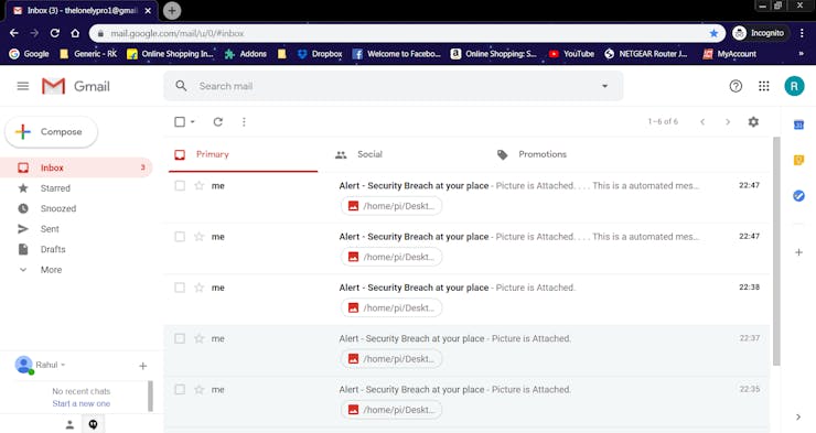

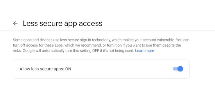

First, we add the Smtplib package allows us to set up the Gmail server. Install an SMTP service with the command
sudo apt-get install ssmtp
Screenshot - SMTP package
Make sure that Allow less secure apps setting is turned on for allowing Gmail SMTP Access Authentication.
SMTP - AUTH
SMTP - AUTH

By making several adjustments to the code, you can change the Subject, sender address, receiver address, and the content of the body. The images are sorted and the latest image is sent via Gmail (SMTP).
Screenshot of the Gmail

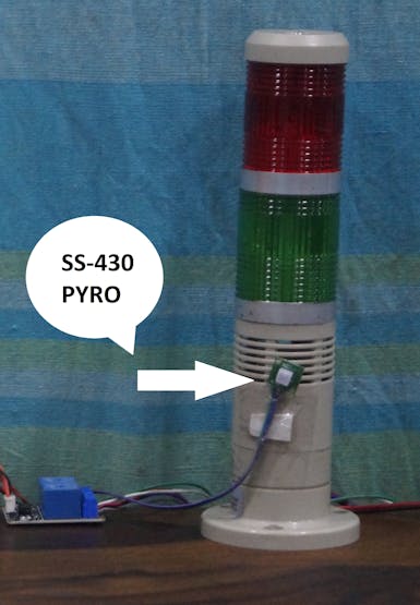

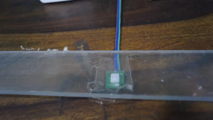

  • A small section is needed to attach the SS-430 pyro sensor to the project. I have adhered the sensor to the Indicator firmly as shown below.Indicator with SS-430
  • Make sure that the required wires/connects are soldered to the raspberry pi. This is a crucial part to meet the size of the device. I have used the terminal block connector to make the common connections. One end of the wires is soldered to the Raspberry Pi.Cables soldered to RPi & End of the wires to terminal block
               Cables soldered to RPi & End of the wires to a terminal block

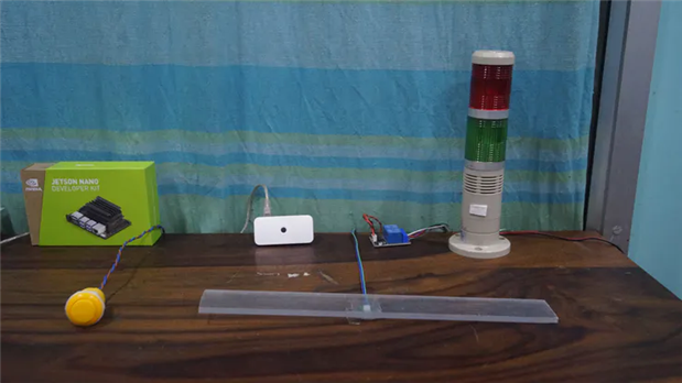

  • Now Insert the device inside the enclosure and It would look something like thisFinal Setup1
Final Setup
Voila! The connection is done and we are equipped to test it.
Working of the Project image
To test the real-time scenario, we deployed it on one of the jewelry shops to test how possibly it could help them and the results were pretty supportive.
