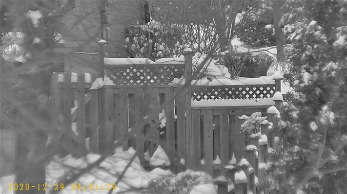

    My IR images just show up as ordinary jpegs:
    There is 500 - N, preallocated files in the photo directory, but they don't have an image extension.
    I seem to have better luck garbing a video frame for an image versus taking a photo as I can pick a frame where the camera shake isn't noticeable.

    Playing around earlier I did end up with a bad image file
    Not sure how, only guess I have is the image was overexposed. Perhaps only largely dark images work, I don't know. That's annoying.
