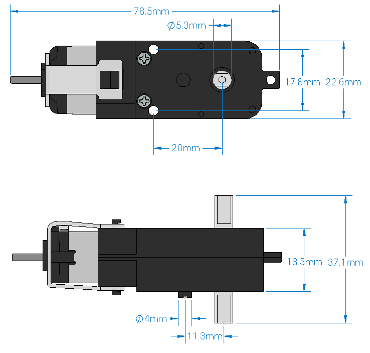

1. Right Angle Gear Motor: voltage is 4.5-6V with a no load current of 190mA, output shaft is 9mm long and the gearbox ratio is 48:1 with a wheel speed of 140 RPM (unloaded)

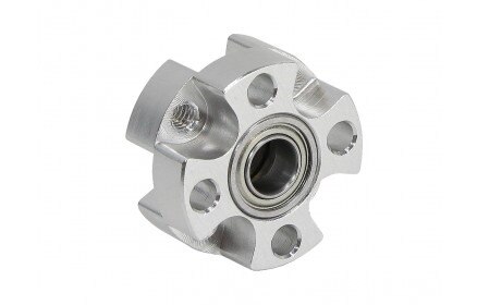

2. Dual Ball Bearing Hub

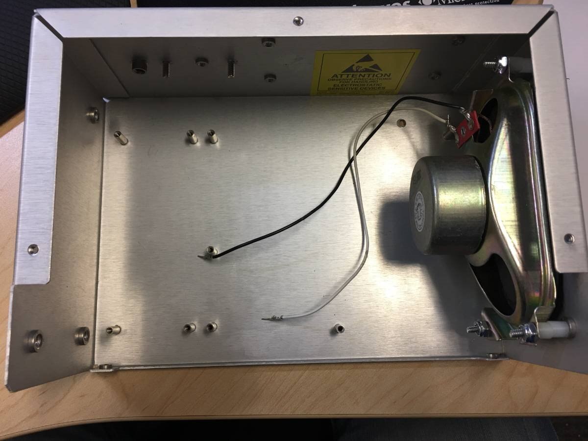

6. Aluminum box "I found it in the recycling where I work"

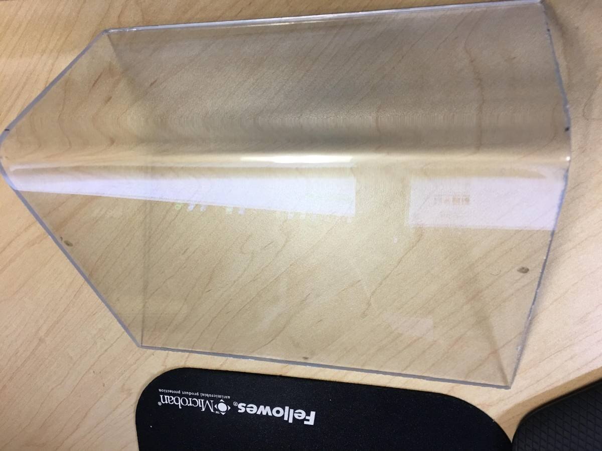

7. Plexiglas cover.
8. 8 ohm speaker

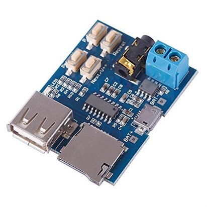

9. Mp3 Player Audio Decoder Board

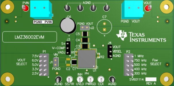

10 Switcher Power Module  LMZ36002EVM see below for more info
RoadTest Review the TI LMZ36002EVM - Review

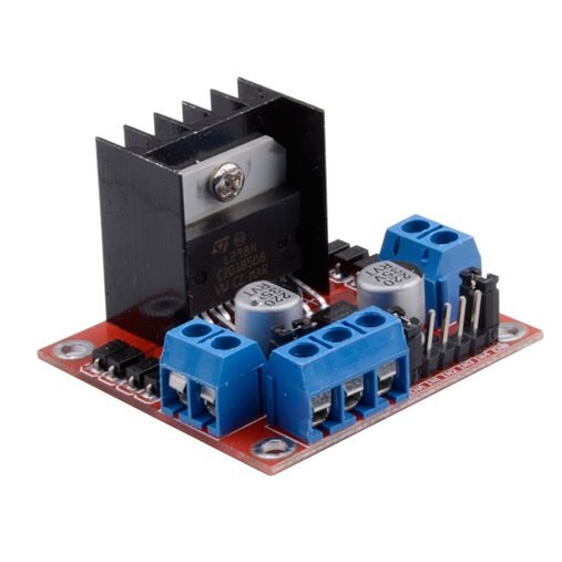

11. L298N Motor Drive Controller Board Module Dual H Bridge.

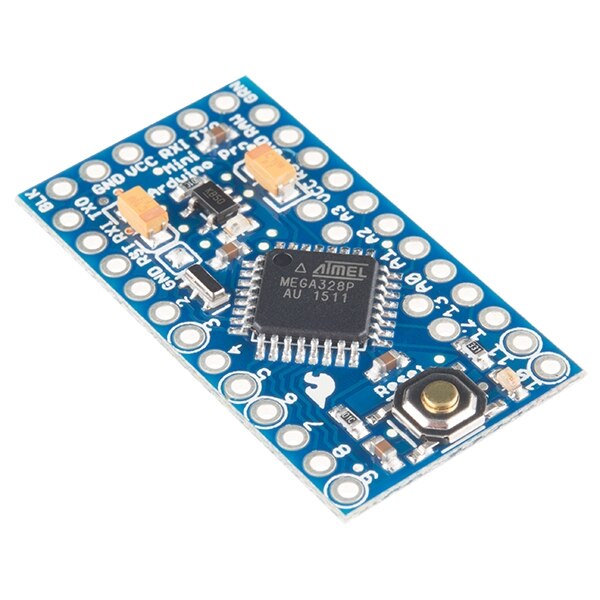

13. MCU ATMEL ATMEGA328P
Figure (1): Right Angle Gear Motor
Figure (3): Dual Ball Bearing Hub
Figure (4): Dual Ball Bearing Hub
Figure (6.8): Aluminum box with speaker.
Figure (7): Plexiglas cover.
Figure (9): Mp3 Player Audio Decoder Board
Figure (10): Switcher Power Module  LMZ36002EVM
Figure (11): L298N Motor Drive Controller Board Module Dual H Bridge.

Figure(13) MCU Arduino Tiny

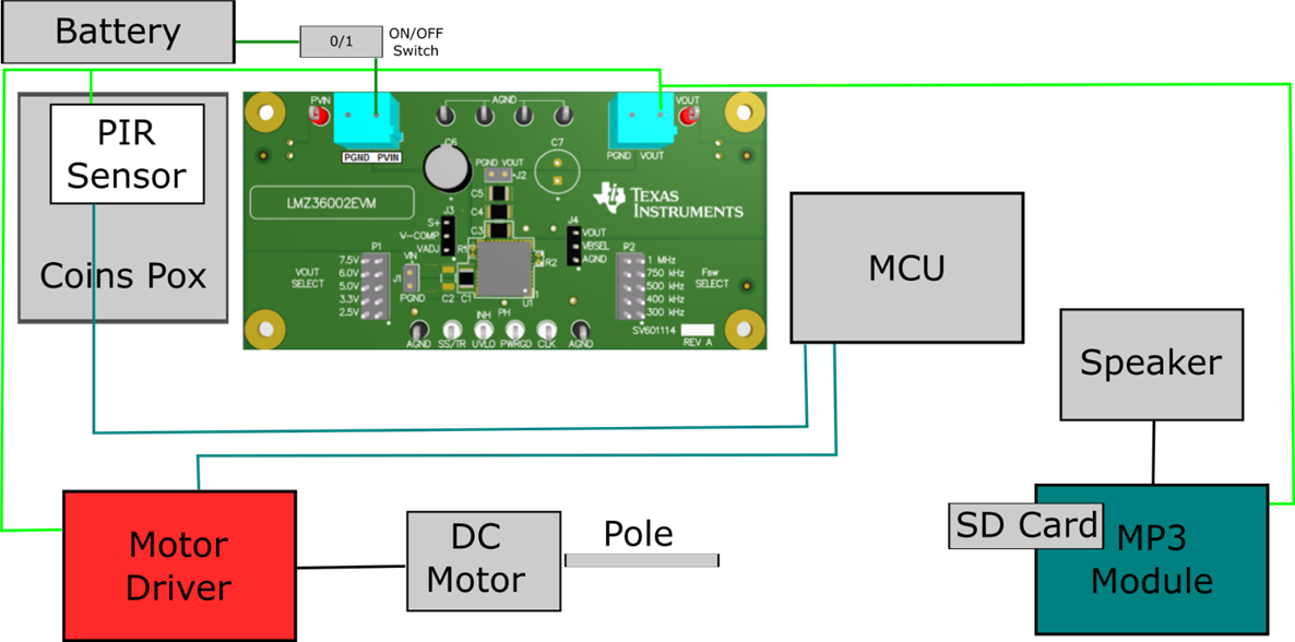

Full System:
