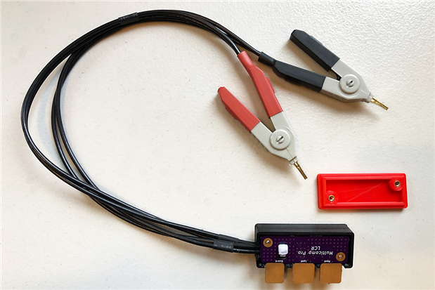

This is a follow-up to my review of the Multicomp Pro Handheld LCR MeterMulticomp Pro Handheld LCR Meter.  In that review it was noted that the meter does not come with Kelvin clamps and that the manufacturer did not appear to offer them.  In this post I describe a set of DIY Kelvin clamps.
Thanks to Shabaz and Jan Cumps for the design suggestions in the comments of the original post.
Design Features

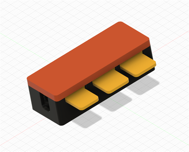

The design consists of a PCB for adapting the Kelvin clamps to the LCR meter and a 3D printed enclosure.

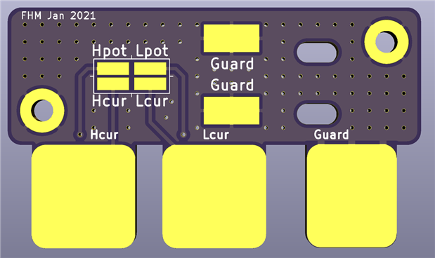

PCB Design
  • ENIG finish
  • 4-Wire connection of clamps
  • Guard connections for shielded cable
  • Connections on bottom of PCB, Faraday shield on top with stitching to bottom
  • Openings for zip-ties for strain relief
  • 4-wire connection footprint allows 0603 and larger parts to be soldered directly to the PCB for testing
  • Designed so that adapter cannot be inserted incorrectly
The Multicomp Pro Handheld LCR is a rebranded Hantek 1833C meter.  Because the "fingers" that attach the adapter to the LCR vary from instrument to instrument this adapter may not fit other LCR models.  The PCB was fabricated by OshPark and the Gerber files can be found here.  The cost for 3 is approximately $16 including shipping if ordered from OshPark.

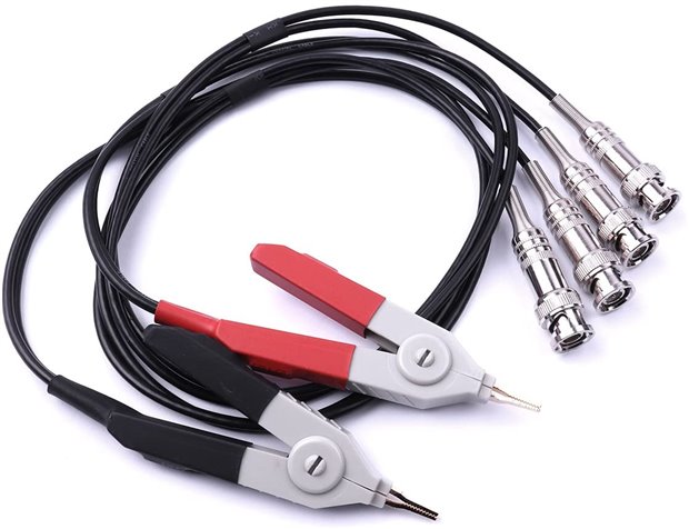

Kelvin Clamps
There is a very good post by Shabaz on how to build your own Kelvin (4-Wire) Test Leads that can be found here.  I bought a shielded pair with BNC connections off of Amazon for $13 (with a coupon) and was surprised to find they were well shielded and the core wire of a decent diameter.  The clamps themselves are OK for the use I will give them but not of professional quality.  The BNC connections were removed and the leads were cut to 40 cm and soldered onto the PCB.
I recommend soldering the shielding to the guard footprints first.  Be careful as the connections are close together and test for undesired shorts between connections after soldering.

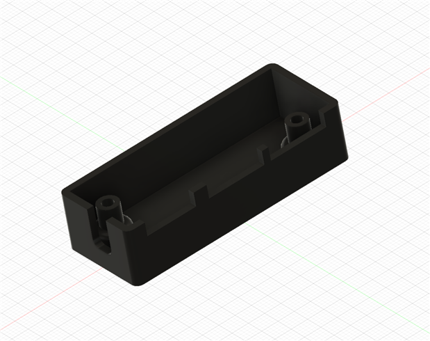

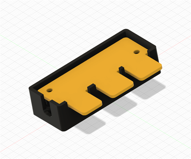

  • Print consists of two parts, top and bottom.
  • Requires two 3mm bolts and threaded inserts.
  • Bolts are inserted into a recess in the bottom, must be cut to approximately 18 mm in length
The enclosure was designed with Fusion 360 and the STL files can be found here for those who would like to print it.  The closest bolt length I had at hand was too long so they were cut to length.  Threaded inserts were used to allow multiple opening and closing of the enclosure but threaded screws could be used if that is not required.

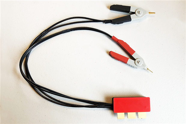

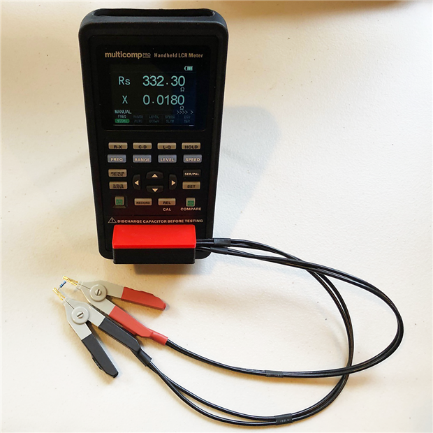

Completed Project
The project looks and works well.  If this was something that was to be done on a larger scale the enclosure could be modified for a 20 mm long bolt (which I did not have on hand) but otherwise there isn't much I would change for now.  Comments and suggestions are always welcome.
