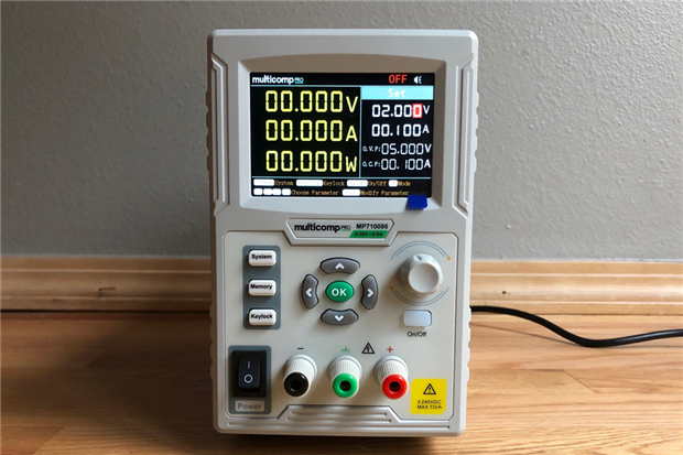

User Experience
I find the input and navigation controls easier to use and more intuitive on the Multicomp Pro MP710086 and easier to use than the less expensive Tenma 72-2685 (although the Tenma user interface isn't that difficult to adjust to).  Both use encoders and are much easier to set accurately than power supplies with potentiometer input.
The system setup and storage / recall of settings is easy to use.  The addition of an on / off switch for the load and a keylock are useful upgrades. The unit also allows over-voltage and over-current protection to be set.
The primary display is well laid out and easy to read.
The secondary display has a graph which can show either voltage or current.  Unfortunately the scale is fixed and for the range of voltage and currents I use is of limited use.  The display below shows 320mA with the Y axis range 0A to 6A.
Overall I like the user experience and find the unit to be of good value.  The MP710086 is a good upgrade from the most basic power supplies on the market.  It lacks 4-wire, LAN, and numeric input found on instruments the next level up.

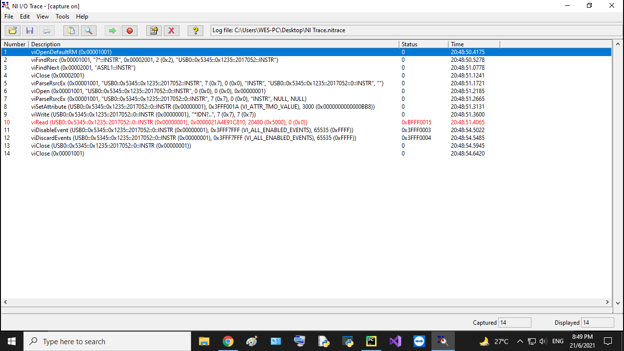

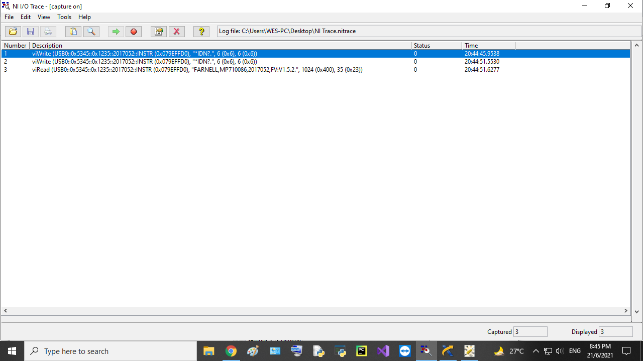

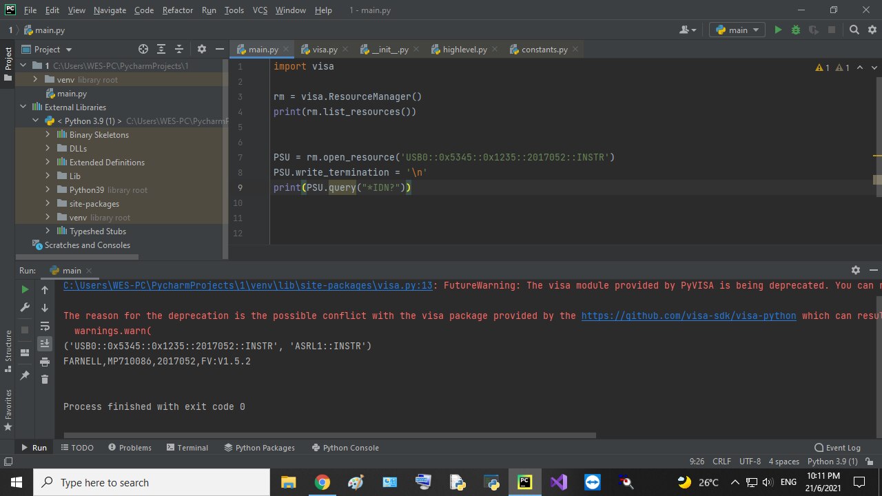

    Hi
    Finally able to see the Brand FARNELL,MP710086,2017052,FV:V1.5.2
    However, can make out what this error is all about:
    The reason for the deprecation is the possible conflict with the visa package provided by the https://github.com/visa-sdk/visa-python which can result in hard to debug situations.
      warnings.warn(
    Many Thanks
  • Gough Lui
    Gough Lui over 5 years ago in reply to edax
    Use "import pyvisa" instead of "import visa" is what that warning is saying (and wherever the package name is referenced) as there is another package that shares the "visa" package name.
    - Gough
  • edax
    edax over 5 years ago in reply to Gough Lui
    Hi
    Good Day
    Somehow when I start Python the first time and sometimes intermittently it throws in a Error!
    However If I run again it runs perfectly.
    Its not consistent and predictable, however if run again its OK
    Thx & Br

  • Gough Lui
    Dear Eddy,
    I can't call myself a Python expert and I'm not sure what the "Error!" you are referring to looks like. It could be down to your particular installation (conflicts can occur if you have multiple copies of Python installed) or a particular library. Regardless, I would suggest you collect more detailed information about your issues, do some research of your own to see if you can solve the problem yourself (as it's often quicker) and perhaps start a new thread as the issue is starting to diverge from issues with this power supply.
    - Gough
