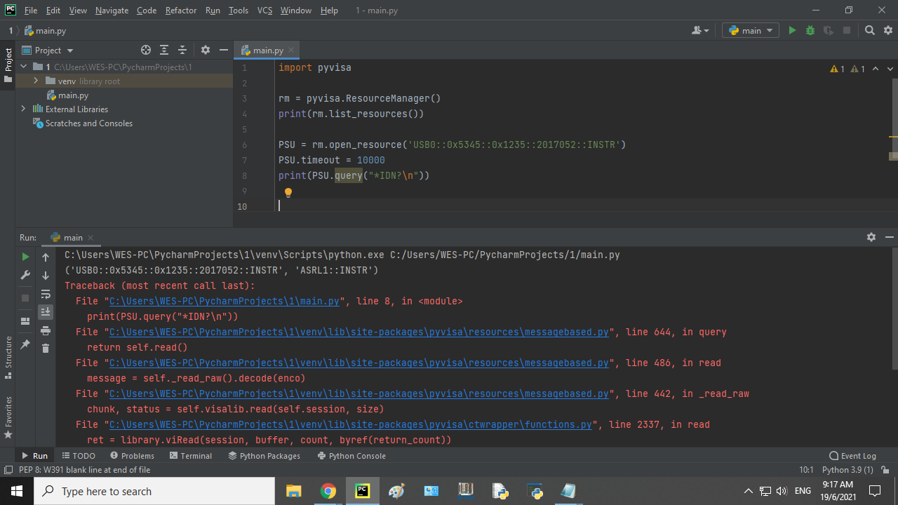

    edax over 5 years ago
    Hi
    I have tried using IDLE Shell IDE
    Regards

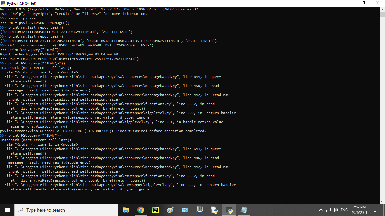

  • edax
    Hi
    I tried using Python 3.9 (64-bit)image
    Regards
    Hi
    Tried out PSU.timeout = 10000
    Pls see attached image
    Errors remains.
    Thx & Br
