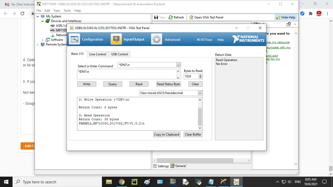

Update 19 May 2021:  Gough Lui found documentation, including SCPI, for the Owon SP/P series power supply that the MP710086 appears based on and kindly posted a link in the comments below.  I will leave my observations here as they appear to be essentially the same.
A driver was not required and the instrument showed up on National Instrument NI MAX as shown below:
The National Instruments Test Panel was used to test SCPI commands (use the "Open VISA Test Panel" button in NI MAX).  Setting the output voltage to 3.3V is shown below.
The documentation I prepared for my own use is given below.  Things seem to work but it has not been extensively tested. I've not been able to determine the SCPI commands (if they exist) for several of the features such as memory storage and system commands such as using the beeper.  Use at your own risk.

    Hi Frank, Interesting power supply! It has a good voltage/current range. I think with the better controls and display, it easily makes it the better option compared to the LED model with the two knobs…
  • Gough Lui
    Gough Lui over 5 years ago in reply to edax
    Timeouts usually occur if the command is not recognised by the unit or the response takes the unit longer than expected to respond.
    You could try increasing the timeout by adding
    PSU.timeout = 10000
    after opening the device to set the time-out to 10s. This gives the power supply a bit more time to respond.
    It could also be an issue with the termination character setting, you could try setting
    PSU.read_termination = '\n'
    as well to see if that helps. Otherwise try setting PSU.query_termination = '\n' as well.
    Otherwise, I still suspect your earlier attempt with the add device wizard may have caused a driver conflict. You may be able to identify this if you disconnect the USB cable for the power supply and it still shows up in the list_resources command. As I don't own one of these supplies, I really can't advise regarding to the correct settings - USB-TMC normally doesn't require any special configuration at all.
    - Gough

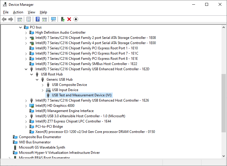

  • edax
    edax over 5 years ago
    Before you might have manually added a driver for the power supply hence it was showing up in the list but not possible to communicate with. You should be able to communicate with the power supply now that it shows up properly in NI MAX.
    Hi
    In NIMAX its able to communicate, However If I attempt with Python Id's its not able to communicate.
    Thx & Br
  • edax
    Hi
    Right you are, In Python ID's listing devices isn't a problem.
    However, if I use the resource name and query using:
    print(PSU.query("*IDN?"))
    Then comes the Errors.
    This errors are found only on my Farnell MP 710086 DC Power Supply.
    I had purchased this DC PSU because its under USD200 and affordable for the students to purchase and write out their Python programs at home.
    and also because it comes with a USB Port and its portable for the students to carry it around with their laptop.
    Hope you understand why I am grounded with this DC PSU and its problems.
    Thx & Br
  • Gough Lui
    Perfect - that's good progress. It means that there might be a hardware incompatibility between your USB 2.0 controller on your computer and the power supply itself - hence its inability to retrieve the USB Descriptor and configure the USB device.
    If you can communicate using the VISA I/O string that is displayed inside NI-VISA, then you can go ahead and start automating. But not being able to list devices may have to do with your pyvisa or python installation and I can't think of a good reason why you are able to work with your oscilloscope but not be able to list the device. Usually it's either "everything works" or "nothing works". Unfortunately for you, I've never encountered an issue with listing resources except for in Linux where USB access permissions came into play or incomplete installations of pyvisa-py/pyusb were the cause. On Windows, this should not be a problem.

  • edax
    Hi Good Day
    Thanks for your kind feedback.
    1. You should not need to use the NI Driver Wizard. If you make drivers for USB devices this way, they will NOT work.
    Noted.
    2. If your device has a USB mode selection, check it is in USB-TMC mode rather than USB-CDC (or COM) mode.
    I realized that if I plug the B USB side to the Computer USB 2.0 socket, the reply from the NI Driver Wizard is:
    *The following error were found when testing the device's compatibility with VISA:
    [Device Id: USB\VID_5345&PID_1235] ERROR - 1073807174: Device descriptor error - unexpected DescriptorType(expected USB_STRING_DESCRIPTOR)*
    BUT if I plug the B USB side to the Computer USB 3.0 socket, the reply from the NI Driver Wizard is:
    *This device is a member of the USB Test and Measurement Class (USBTMC). Ni-VISA can already detect and control it.*
    3. You should be able to see your device in the Device Manager properly installed (i.e. no yellow triangle) with the USB IVI foundation drivers - see if you can find it under USB Test and Measurement Devices. If not, you won't be able to get your instrument working until it has been detected with the right drivers. Try a different port or upgrade your NI-VISA if you're still having trouble.
    4. Opening NI MAX, you should be able to find your device under "Devices and Interfaces".
    In NI MAX able to see Device:
    5. If you do, you can select the VISA I/O Test panel to see if you can communicate successfully through NI-MAX.
    Not being able to list devices out of pyvisa is very unusual and often speaks of problems with drivers or permissions.
    This is only OPEN point since many weeks somehow using Python ID's not being able to communicate.
    Appericiate your kind follow up.
    - Gough
