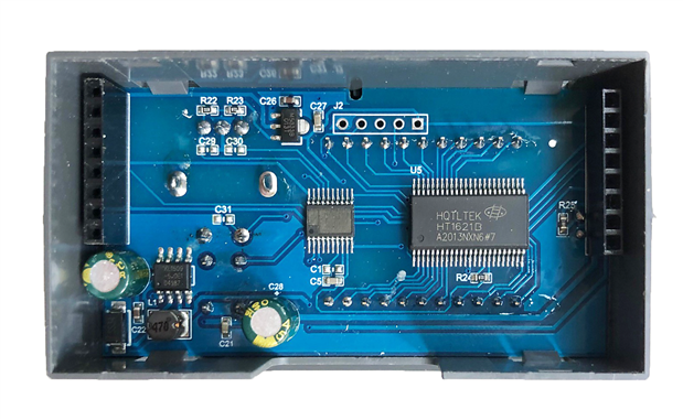

Take it Apart
It arrived packaged nicely enough and undamaged.  The enclosure is designed to be snapped into a panel and is open in the back.  There are two PCBs sandwiched together with 0.1-inch headers that pull apart easily with no tools.  The PCB on the back has the fan attached and a TIP122TIP122 BJT Darlington NPN transistor that serves as the load.
The PCB attached to the front has the microcontroller and a chip with the identification sanded off.  It also has some solder spatter.
