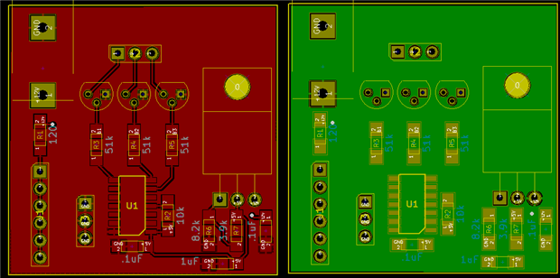

Once I was satisfied with the schematic, I designed the PCB. It is a two-sided PCB, but there are no components on the backside. The top is the ground plane, the bottom is the 12v plane. The image below shows the top copper on the left (red) and the bottom copper on the right (green).
I sent this design to OSH Park and received three boards a couple weeks later. Since this was my first PCB design, I was quite happy with the results. There were only two problems. First, the footprint of the barrel jack did not match the actual component I had. I ended up abandoning the barrel jack and just soldered the power wires directly to the board. This actually made the assembly process easier, so I wasn't upset about it. Secondly, some of the resistor values were wrong in the schematic (particularly the 51k transistor base resistors). I'm not sure why I used those values, my prototype breadboard circuit used 1k resistors. Fortunately, it is easy to just use different resistors. I should also note that you may notice other resistor values are different than the schematic. This is because I did not have that particular value available in SMD form, so I had to use a resistor that was close enough. You can see the front/back of the blank board below.
