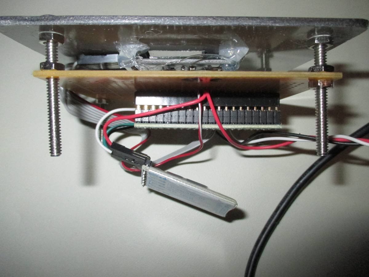

So, I have completed my DIY FLiP Connected X-Mas Ornament and displayed it on the old X-Mas tree.  It all seems to be working fine and I even added the option to dim certain colors.  Also, I created a case to house the FLiP, OLED and Bluetooth module and added some extra pieces to the case to give it a bit of a Steam Punk look.

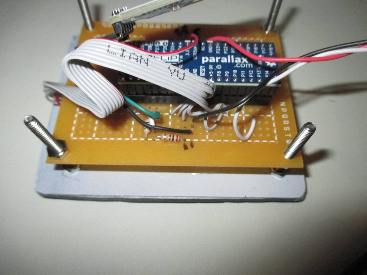

Image of the board I put together for the Parallax FLiP circuit
Parallax FLiP, OLED, and Bluetooth modules connected to fron panel:

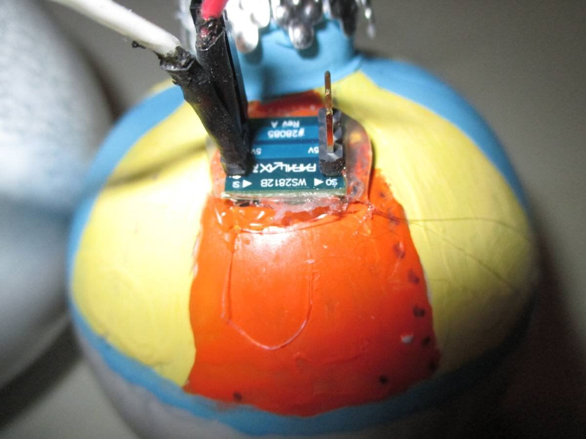

RGB Module connected to back of Ornament:
I created a case to house the Parallax FLiP, OLED and Bluetooth Module from clear Acrylic and Back Plastic and then painted it with  Metallic Oil Rubbed  Bronze looking paint.  The edge, face plate, and buckles are from the Jim Holtz idea-ology line of ornament pieces bought at a local Craft store.
