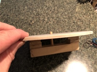

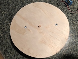

I started by cutting a circular piece of plywood for the dial face. The size was determined by the size of the leftover bits I had in my workshop image

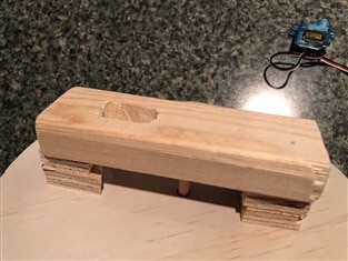

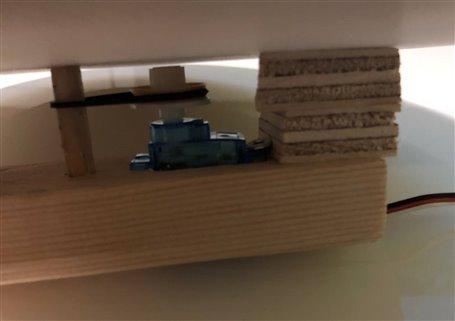

To hold the servo, I added a few pieces of wood to the bottom of it. The longer piece has a slot to hold the servo, and there are some plywood spacers to allow the top of the servo to remain below the plywood circle.

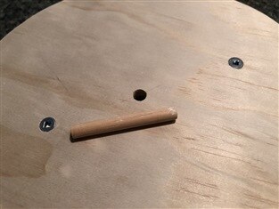

The spindle is a short piece of hardwood dowel. I drilled a hole through the dial face that was about 1/16" larger then the dowel diameter. I also sanded the dowel to allow it to rotate freely. in the bottom longer piece of wood I also drilled a hole to hold the bottom of the dowel in place.
One issue I noticed early on in the build was that a normal speedometer type gauge has about a 300 degree sweep, while my cheap little servo didn't even make it to 180. That meant I needed a little gearing to give it the extra range.
To get that gearing, I glued a small plastic pulley onto the servo (on top of the circle thingy that comes with the servo), and I used a wooden dowel for the main spindle that holds the needle. I had a little rubber band to connect the two.

The dowel itself was a bit slippery so during my first tests the needle would often lose the position over time, and there seemed to be a particularly smooth spot near the 70% mark where it would then stop moving. The easy fix was to just wrap the spindle with some double-sided sticky tape. Worked like a charm!

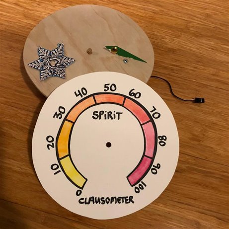

To make it look like a real Clausometer, my wife drew out the graphics for me, and for the center she cut a snowflake design which I think she said came out of an old Christmas card. The needle is cut out of a business card. I later used a permanent marker to colour it black. It pushes into the top of the wood dowel spindle with a thumbtack. I predrilled for that because the dowel is such hard wood, but then I had to fill the hole with glue because it was too big.

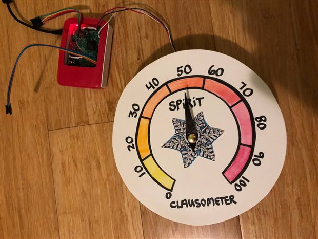

To wire it up, simply connect the servo data/control line to GPIO18 (pin 12), and connect power and ground. (The image shows a few extra wires that I didn't end up using.)

As it turns out, Christmas spirit in the Twitterverse is quite high at Christmas time image
