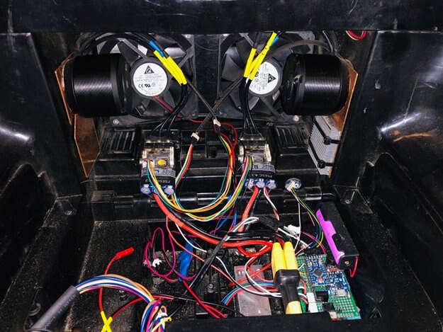

5000W Dual Drive Electric Car
deolee
deolee
12 Jan 2020
Hello guys,
For this year's Holiday Special 19 project, I decided to embark on an fun and exciting journey to modify and upgrade an 50W BMW i8 electric baby car, which originally could barely move when i sat on it, to a fast and furious 5000W dual drive electric car which can hit top speeds of 60km/h. I was initially skeptical on whether this project was feasible and could be completed within the month. However, after overcoming many of the difficulties and challenges, I am very happy to finally present to all of you a compilation video of my journey in bringing this project to life.

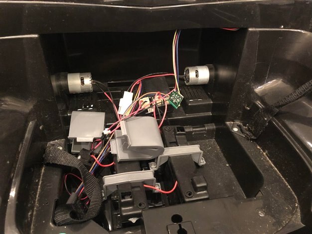

Photos of key installations
BEFORE
AFTER

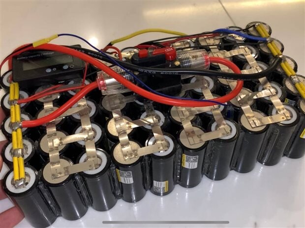

Unboxing the 50x 26650 Batteries
Assembled Battery (36v 25Ah)

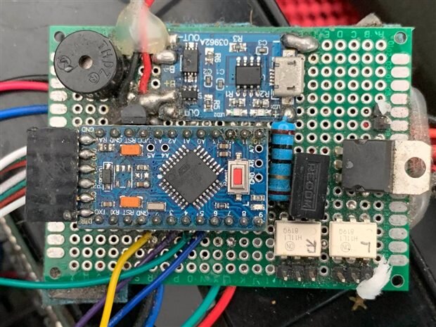

Main Car Central Control Circuit (Front)

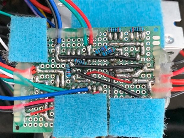

Main Car Central Control Circuit (Back)
