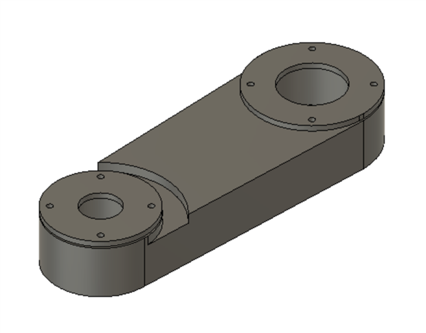

Hello guys,
For this year's Holiday Special 19 project, I decided to embark on an fun and exciting journey to modify and upgrade an 50W BMW i8 electric baby car, which originally could barely move when i sat on it, to a fast and furious 5000W dual drive electric car which can hit top speeds of 60km/h. I was initially skeptical on whether this project was feasible and could be completed within the month. However, after overcoming many of the difficulties and challenges, I am very happy to finally present to all of you a compilation video of my journey in bringing this project to life.

Fusion 360 - Motor pulley
Fusion 360 - Wheel pulley
Fusion 360 - Steering wheel throttle mount
Fusion 360 - Spacer with bearing holder
Fusion 360 - Pulley Load Stress Simulation
