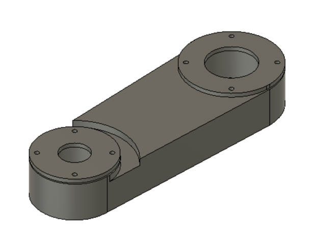

Hello guys,
For this year's Holiday Special 19 project, I decided to embark on an fun and exciting journey to modify and upgrade an 50W BMW i8 electric baby car, which originally could barely move when i sat on it, to a fast and furious 5000W dual drive electric car which can hit top speeds of 60km/h. I was initially skeptical on whether this project was feasible and could be completed within the month. However, after overcoming many of the difficulties and challenges, I am very happy to finally present to all of you a compilation video of my journey in bringing this project to life.
Video
Video Contents
0:00 - Project Overview
0:14 - Main goals of electric car
0:32 - Comparison between Old and New components
3:16 - Gear Ratio calculation
3:59 - 3D Printing wheel and motor pulley
4:13 - Car throttle and brakes setup
5:32 - Controlling car front headlights
6:07 - Car power up sequence
8:36 - Car secondary battery
9:08 - Car secondary battery life calculations and implementation of sleep mode
9:36 - Optocoupler isolation for arduino microcontroller
10:24 - Assembly of electronics on pcb
10:46 - Installation of wheel pulley
11:09 - Mounting of brushless motor
11:31 - Overcoming flex of car plastic frame
12:20 - Car cooling system
12:40 - Battery charging and bms
13:01 - Programming of VESC
13:17 - Demonstration of power up sequence
13:40 - Journey of failures and success
Photos of key installations
BEFORE
AFTER
Unboxing the 50x 26650 Batteries
Assembled Battery (36v 25Ah)
10 Inch wheel with 3d printed pulley
Custom 3d printed mount for 36W car LED
3D printed steering wheel mount to attach 2x thumb throttle
Main Car Central Control Circuit (Front)
Main Car Central Control Circuit (Back)
Car Power Mosfet Circuit
Fusion 360 - Motor pulley
Fusion 360 - Wheel pulley
Fusion 360 - Steering wheel throttle mount
Fusion 360 - Spacer with bearing holder
Fusion 360 - Pulley Load Stress Simulation
Circuit Schematic
Parts & Components

Arduino Code
#include <Servo.h>
#include "LowPower.h"
#include <R551_Fingerprint.h>
#include <SoftwareSerial.h>
Servo leftVESC;
Servo rightVESC;
//A0 - Left Analog Throttle
//A1 - Right Analog Throttle
//D2 - Left & Right Throttle Power
//D3 - R551 Finger Detection Signal
//D4 - R551 RX UART
//D5 - R551 TX UART
//D6 - Front LED Lights
//D7 - Main Power System
//D8 - Left ESC Signal Input
//D9 - Right ESC Signal Input
//D10 - Force Speed Limiter
//D11 - Buzzer
//D12 - Lights State Switch
unsigned long lastFingerOnSensorMicros = 0;
SoftwareSerial mySerial(5, 4); //RX, TX
R551_Fingerprint finger = R551_Fingerprint(&mySerial);
//for sound feedback
int delayTime = 50;
int toneFrequency = 2900;
int currentUserID = 0;
    int maxSpeedLimitArray[] = {100, 50, 50, 50};
    //For Speed limiting different users [Enter Speed limit from 0(Min) - 100(Max)]
    //currentUserID 1 - Amadeo
    //currentUserID 2 - Friend 1
    //currentUserID 3 - Friend 2
    //currentUserID 4 - Friend 3
    int currentSpeedLimiterMode = 1;
    //double tap - exit all modes (Mode 1) (100% throttle)
    //single tap - police slow mode (5km/h) (Mode 2) (25% throttle)
    //3 taps - trial mode slow (15km/h) (Mode 3) (35% throttle)
    //4 taps - trail mode fast (30km/h) (Mode 4) (45% throttle)
int lightSwitchState = 0;
boolean previousLightStateButtonHIGH = true;
boolean previousSpeedLimiterButtonHIGH = true;
unsigned long lastButtonPressedMillis = 0;
