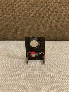

Enough theory for now, the assembly was done with the above components on a PCB prototype breadboard. First, I attached the LEDs and transistors in the desired shape and used the “legs” for connection. Afterwards, I soldered the two SMD transistors to the bottom side and added the switch. An old computer motherboard gave me, with a bit desoldering effort, a coin cell battery holder which I also attached to the bottom side of the PCB. Finally, two screw extensions are used to form a stable standing at the same time J1 and J2 for the touch response.
In the end, I used black paint to give a nice finish and insulate the bare wires on the back.

The result is shown in the video below. As already described at the top the circuit has a large smile factor. As the first “victim” I choose my girlfriend. First I switched it on and got the standard “Oh…” but when I told her to hold one side (while holding the other side myself) and put my hand into mine her eyes turned big “Woooow how is this working?!?!”image image
