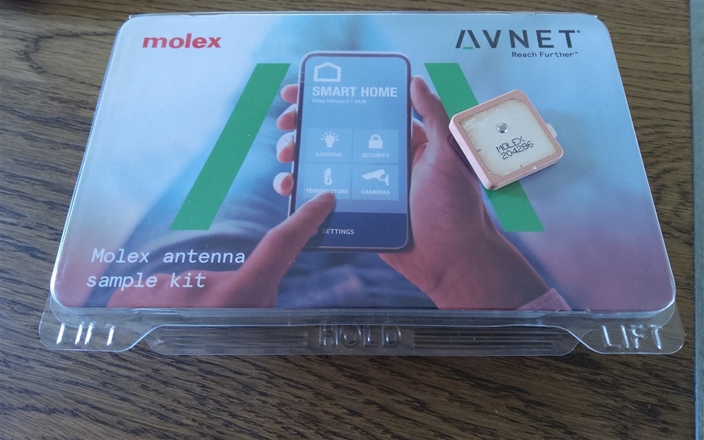

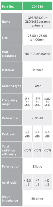

  • The antenna used is TAOGLASS CGGBP.25.4.A.02. https://www.taoglas.com/datasheets/CGGBP.25.4.A.02.pdf
    If you've participated in the  Antenna Essentials: Key fundamentals that impact your RF system and steps to optimize antenna performance , you may have received a Molex antenna sample kit.
    Two of the antennas in that kit match the footprint of the TAOGLASS one. In particular the 204286 - GNSS ceramic antenna (https://be.farnell.com/molex/204286-0001/gnss-antenna-1-597-1-607ghz-5/dp/3498939) seems to have comparable RF specs too. (datasheet: https://www.farnell.com/datasheets/2576924.pdf, application note: https://tools.molex.com/pdm_docs/as/2042860001-AS.pdf).
    source: AVNET selection document https://www.avnet.com/wps/wcm/connect/onesite/b27b2169-6550-48cb-9c3c-b678548e021d/Molex-Antenna-Guide-US-K1112.pdf?MOD=AJPERES&attachment=false&id=1521591820244
    It could be interesting to see if the projects behaves different with the Molex or TAOGLASS component.
