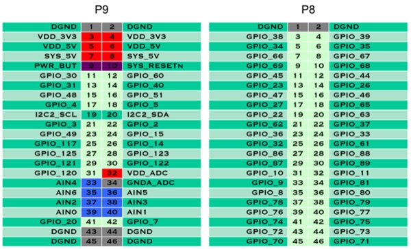

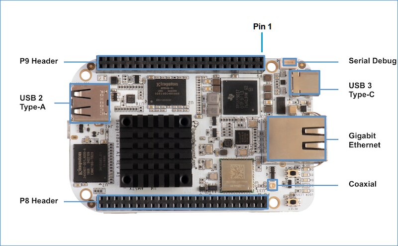

  • There are two pin headers on the BBAI.  With the ethernet port on top, P9 is on the left and P8 is on the right.  Pins are often referred to in the format P9.2, which would be the top right pin of the left header when oriented such that the ethernet port is on top.

  • Show pin configuration (aka the pinmux) - note the pin IDs in column 2 are off due to architecture differences with the BBB
    /opt/scripts/device/bone/show-pins.pl⏎ or
    show-pins⏎

ANALOG INPUT

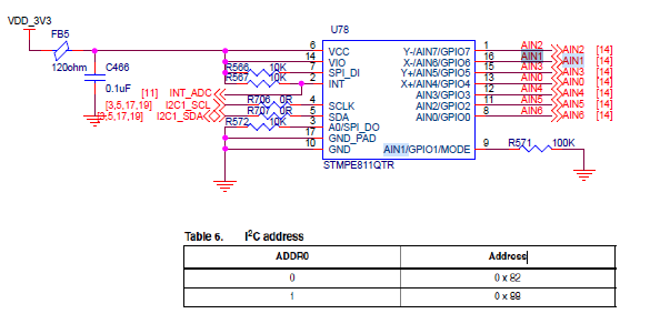

Analog input is useful for communicating a degree of magnitude from a component.  It is actually the least used way to get input by me for any project I've ever done.  In fact, I have only used it with potentiometers to communicate desired servo position or audio volume.  Some older sensors, though, would use it to communicate the measured value within their output range.  You would do math on the microcontroller to ratio that input to a useful value such as distance.
Although the utility show-pins doesn't show it and the spreadsheet referenced in the References section doesn't reflect it, pin P9.33 is an analog in paired to "in_voltage7_raw" in the "sys" folder.  It reads 0-1.8V and outputs a range of 0-2000ish.  I found it testing the output as shown here:
debian@beaglebone:/var/lib/cloud9/BeagleBone/AI/backupcamera$ cat /sys/bus/iio/devices/iio:device0/in_voltage7_raw #jumper between P9.33 and P9.01 (GND)
0
debian@beaglebone:/var/lib/cloud9/BeagleBone/AI/backupcamera$ cat /sys/bus/iio/devices/iio:device0/in_voltage7_raw #jumper between P9.33 and P9.03 (3.3V)
4095
With this we can simply read using any language that reads a text file.  See analogIn.c in Code Examples below.
Note, the ADC reads up to 1.8Vs which can be supplied to your components reference voltage by Pin 9.32 (For example, the voltage for a potentiometer).  However, I did test 3.3V on the analog in pins and it gave a stable 4095 as the return value.  Thanks to Fred Bogardus, he confirmed that the ADC of 1.8V is for backwards compatibility with older Beagle boards.  The AI will take 3.3V since the STMPE811QTR can handle 3.3V on the analog in as shown on this schematic:
STMPE811QTR Schematic
sys file pin mapping
I could only safely locate 3 pins for analog read, although the spreadsheet shows 8.
/sys/bus/iio/devices/iio:device0/in_voltage7_raw     P9.33
/sys/bus/iio/devices/iio:device0/in_voltage4_raw     P9.35
/sys/bus/iio/devices/iio:device0/in_voltage6_raw     P9.36

20: -- -- -- -- -- -- -- 27 -- -- -- -- -- -- -- --
30: -- -- -- -- -- -- -- -- -- -- -- -- -- -- -- --
40: -- -- -- -- -- -- -- -- -- -- -- -- -- -- -- --
50: -- -- -- -- -- -- -- -- -- -- -- -- -- -- -- --
60: -- -- -- -- -- -- -- -- -- -- -- -- -- -- -- --
70: -- -- -- -- -- -- -- --
debian@beaglebone:~$
My LCD Display address for i2C is x27 which received a confirmed hit with i2cdetect as shown above.  See Code Examples for an I2C LCD c program.

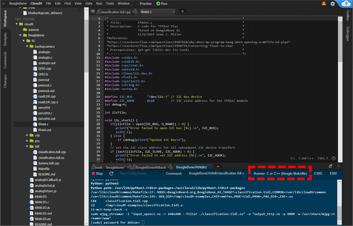

Setting the Runner in Cloud 9 for C and C++
To use this code, you can right click in the Cloud9 IDE on a directory of choice and select New File.  You can name it what you like.  Be sure the extension matches the programming language, though.  (js for javascript files, c for C files, cpp for C++, py for Python).  After pasting the code in the new empty file, press CTRL s to save and click the run button as desribed above.

Power and Ground Pins
DGND: this is the digital ground to connect any digital devices
GNDA_ADC: this is the analog ground used to connect any devices that return an analog signal such as a potentiometer
VDD_3V3 - use this to power 3.3v electronics
VDD_5V - use this to power the beagleboard (i.e. through a barrel jack, if you are going to put one on the cape/shield), NOT to power 5V electronics
SYS_5V - use this to power 5V electronics
VDD_ADC - use to connect power analog in devices such as Potentiometers.  (It is 1.8V for backwards compatibility as discussed in the Analog Input section.)

  • themysticturtle
    themysticturtle over 5 years ago in reply to themysticturtle
    also, if i run your pwmout.c program. this is the error i get.  (and the code before it as well for accurate reference)
    Started /var/lib/cloud9/: pwmout.c
