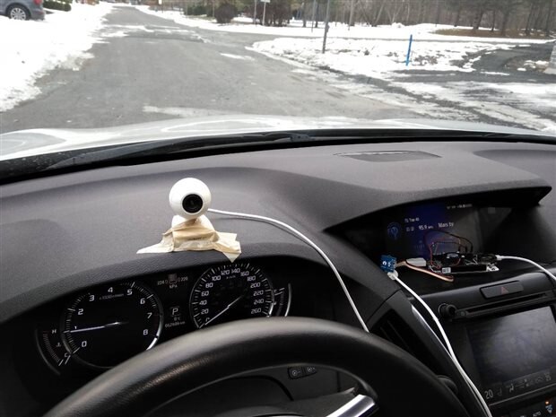

Here is my test setup in the car.
This video captured the real test drive of DSM, where results of processing got captured on video. The young driver did a great job and was focused on the road all times - no alerts where generated during the drive.

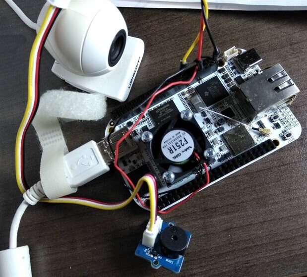

I'm using the following components to implement this project:
Hardware
  • BBAI to detect and analyze the driver's face, eyes, and to check if they are open, if they are focused on the road or if the head is tilted and focused on a mobile phone. It was provided by Element14.
  • USB Webcam
  • Seeed studio buzzer
  • CPU fan F251R-05LLC.  It was provided by Element14.
