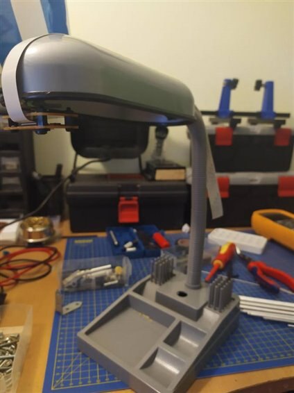

Lamp

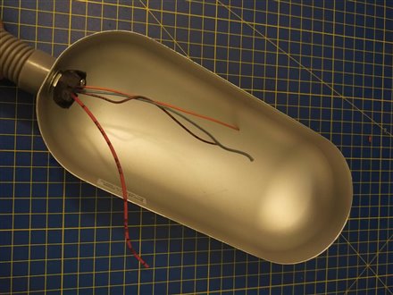

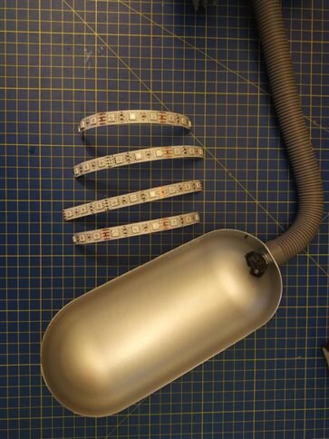

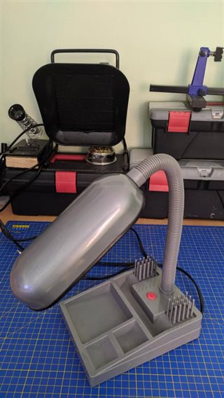

     I'll begin with the biggest part of this project, the lamp itself. This is the lamp that's sitting at my desk which I never use, so I thought why not convert it for this project:
It's a standard 220V single light bulb lamp, nothing special about. There are a few things I like about it which will be useful for this project, it has a pretty heavy base, which means it's really stable (when I took it apart, I found out it's actually a piece of a tile screwed into the base), and the head of the lamp overshoots the base just enough for me to mount my camera to it and for the medication organizer to be underneath. I could have kept the lamp working like a normal lamp, but I decided to convert it to LED with RGB LED strips which I have laying around from a previous project. This will also enable me to use different colors to signalize different things later on.

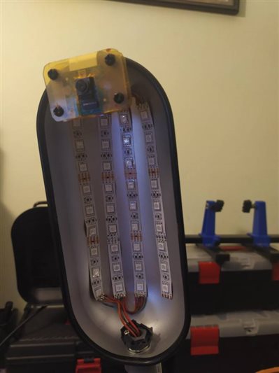

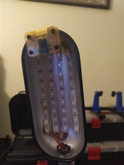

Mounting the RGB LED strips

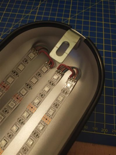

     To mount the LED-s, I cut off 4 individual strips and soldered some wires to connect them. I pulled out the old cable and just routed a few wires where the old ones for powering the whole thing, here is how that process went:
{gallery} Mounting LED-s
Parts: Cut LED strips lamp with removed wiring
Wires in place: I pulled through 4 wires, one for the power, and 3 more for controlling the RGB channels
Finished: I put the strips in with their own adhesive, but as you can see from the pictures I'll probably have to add some hot glue, so it doesn't loosen up over time
All in place: Here is how the finished head looks like, the thing at the top is the camera mount to which I will get shortly!

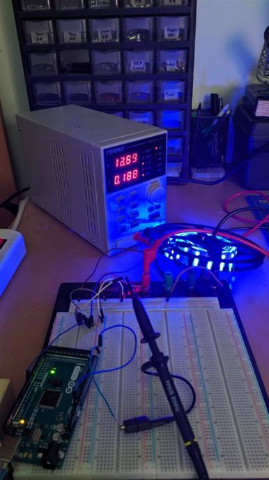

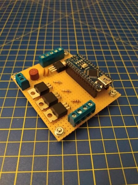

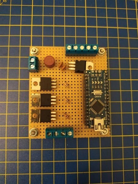

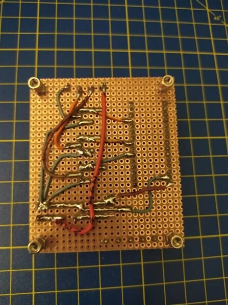

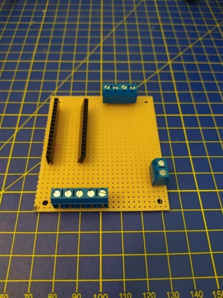

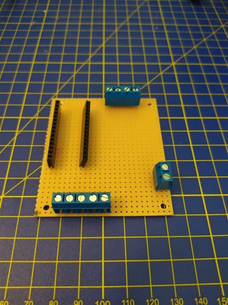

     As I've already said, the RGB controller that came with the LED strip I already used for another project, so I had to either get a new one or try making my own. I went with the second option. My plan was to use an Arduino Nano, since I can later on use serial communication to control it and drive each of the RGB channels using a MOSFET. To test out my idea I connected one of the channels to a N-MOS and wrote a short code for testing out everything.
With the test successful, it was time to make a small board for all of it. The things I need on the board are an Arduino Nano slot, screw terminals for the LED strips, power in, as well as a few for different inputs, power supply, 3 N-MOS. The LED strips are meant to be run at 12V so my plan for the whole project is to use a 12V power supply. As for powering the Arduino on the board, I went with an IC7809 linear regulator with a couple of capacitors to lower the voltage to 9V which I then fed to the Vin pin on the Arduino, I've also added a small fuse for the Arduino just to be sure I don't destroy it (wouldn't be the first one.....).
{gallery} LED RGB Controller
Layout: The board layout I planned out
Top View: I just took a piece of perfboard I had laying around but could have shortened it a bit to make the whole board a bit smaller
Side View: For mounting the board itself, I put in place 4 spacers, one in each corner
Bottom View: The underside doesn't have that many connections as it can be seen in the picture, the only thing I haven't soldered yet are the input connections for the Arduino, because I'm still deciding on all of the ways I plan on controlling it, serial, switch,...

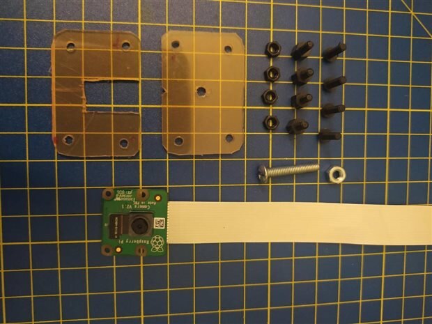

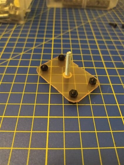

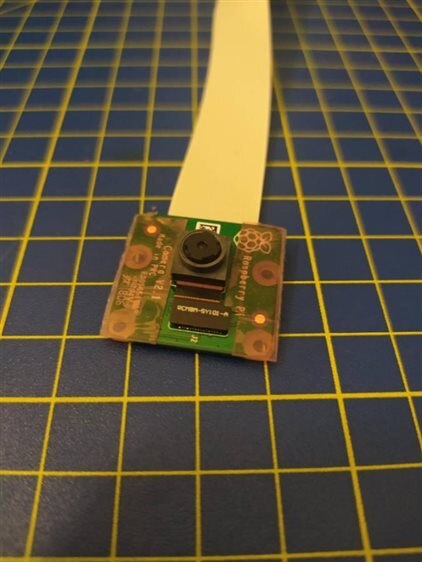

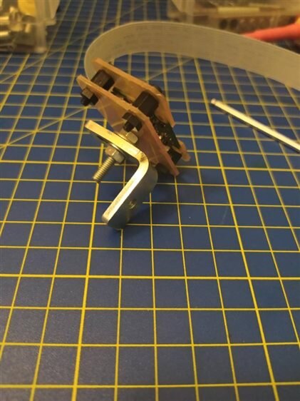

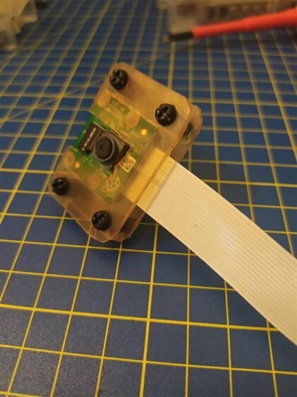

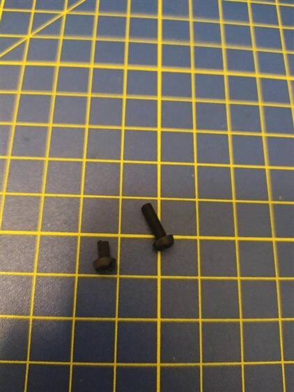

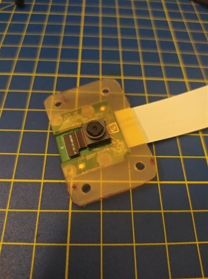

     As I've mentioned, I really like this lamp because I have a really good place to mount the camera. The camera I will be using for now is the Raspi Cam V2. I've used it before and it always worked great for me, I just never liked the small holes which require 2mm screws on it, I can widen the holes on the PCB, but I would honestly rather not do that, so to secure the camera itself I'll be using some double sided sticky tape. Here is how the whole mount turned out:
{gallery} Camera Mount
Parts: For the mount I cut out some the shapes pictured above from a plastic box, I got some plastic screws and spacers, and a 4 mm screw which will be securing the whole mount to the lamp
Top Plate: Where everything goes on the top plate
Tape: I put the double sided sticky tape like this, it's not too strong, so it won't be a problem to remove in the future
Bottom Plate: The notch cut out in the bottom plate is for the camera sensor as it can be seen in the picture
Screws: To assemble everything I needed to shorten the screws, since they were plastic, it was easy to do with wire cutters
Assembly 1: Assembled camera mount
Bracket: For mounting the whole thing to the lamp I used a small L bracket
Mounted Camera: This is how the camera looks like mounted to the lamp now
Lamp: The camera sits exactly where I want it to sit, with a pretty good angle for the medication box, the flat cable I have is pretty long, but I might need to order a slightly longer one, or just mount the Raspberry differently

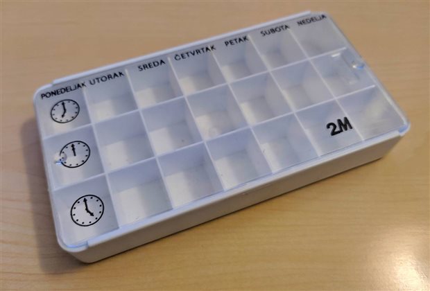

Medication Organizer

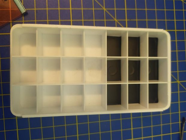

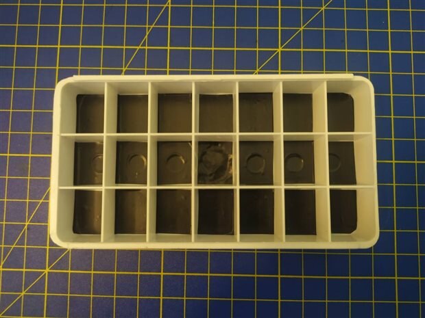

     For now I'll be using the medication organizer I got at the local pharmacy, it is also the same one my grandma uses on a daily basis which an added bonus. But this organizer has a few flaws in my opinion. The lid isn't completely transparent which won't work for this project, the lid isn't really secured in any way and it doesn't fit in that well, so losing pills in a handbag is an actual possibility, and the last thing, it's white, the same color as most of the medication out there, so there really isn't any contrast between the medication and the box. I plan on printing my own box in a different color, but for now, I will just have to cover all of the individual segments with black tape.

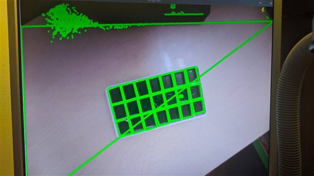

4. OpenCV
     With that, all of the hardware stuff I need for testing is pretty much over, the next step is to power up the Pi, set up OpenCv and go on from there. The way I plan on using computer vision is pretty straight forward, I have to approaches for cutting out the box from the background, either by detecting it with computer vision or by making a magnetic mount to keep in the same place every time. I would like to use a combination of both, but I will see how the project progresses. After cutting out the box, I need to divide it into individual segments and check each of them if they're empty or not. This is sadly the point which I reached with this project for now, a lot of hardware stuff is complete, but I'm just in the beginning with software. I played around with OpenCV a bit, and this is what I got in one of the first tests:
I managed to detect all of the individual segments, but also a lot of stuff besides it. I will have the follow up blog to this coming shortly I hope with a finished project. Thanks for reading, hope you liked it!

    genebren over 6 years ago +5
    Interesting results. Shadows are always challenging when dealing with image processing. I have not used OpenCv before, so my suggestions are untested in your environment, but still may have some value…

    milosrasic98 over 6 years ago in reply to genebren +4
    Hi Gene, Thanks for the great suggestions! My first idea was to detect the whole box, but I had better luck with detecting the individual segments instead. I really love the first suggestion, because it…
    Hi Gene,
    Thanks for the great suggestions! My first idea was to detect the whole box, but I had better luck with detecting the individual segments instead. I really love the first suggestion, because it really sounds like an interesting project on its own, so I will for sure want to try out something like that. Rejecting the objects that are a different size was probably gonna be my next step, but I would still need to filter out the "lucky" ones which are also the appropriate size, which I think would work great with zooming in as you suggested only on the box itself. I had another idea, but didn't have it wired up while I was testing, it was to use the light of the lamp to illuminate everything, I'll just have to play with how strong light I need so I don't get some reflections, but I can control that easily with the RGB controller.
