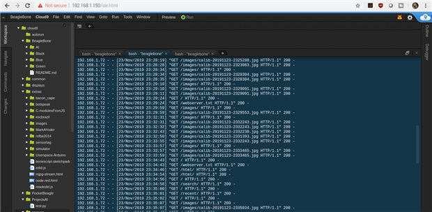

Opening cloud9 I opened a terminal window and then typed:  cd [hit enter]
after that I ran the following code: curl -L https://raw.github.com/pageauc/speed-camera/master/speed-install.sh | bash
once all was said and one and installed it was really fun to get going I have to say this saved me a lot of time getting things going with the beaglebone ai.

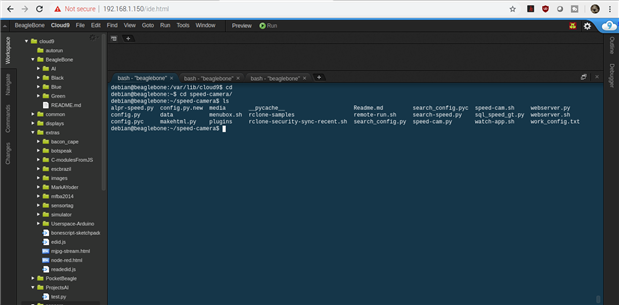

then all I had to do was type: cd speed-camera/

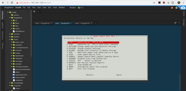

after that:  ./menubox.sh
then I had to start the speedcam.py and webserver.py  you could alternatively run this from the terminal with:
python speedcam.py
and then in another terminal
python webserver.py
But I like the simplicity of the menubox that Claude made.

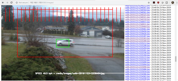

This is where I came across a few problems due to my location first of all I have 2 roads in front of my house one side road and then the highway.
So I could either get accurate readings at this point on one or the other but not both at the same time.  Which makes sense since the height and distance difference.

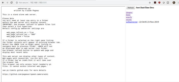

Time to launch the webserver main screen and see what we are greeted with.

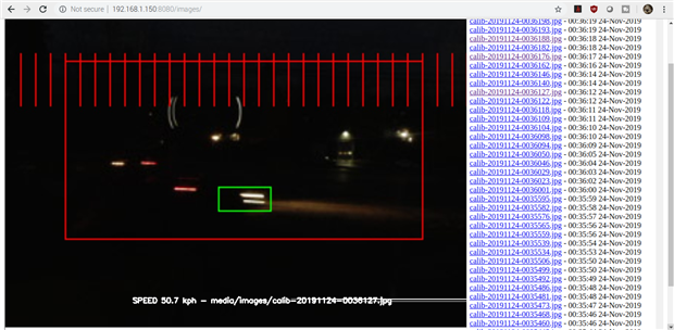

Ok, so this will certainly get a revision in the future for me for sure.  but it does the trick. now on to seeing if we are actually recording some data lets head over to the images folder.
This is where I was able to get a acurate reading on the veichles going by my house the speed limit here is 50 kph so that looks pretty good as a reference to me on the frontage road here.

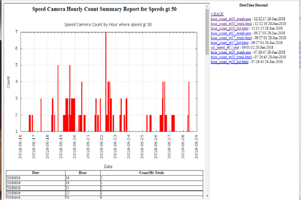

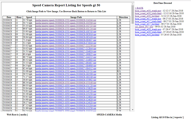

As you can see from the images I took from Claudes page there is  even more data we can go through when it comes to the webserver here.

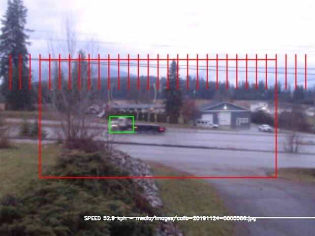

But before I wrap up this project I wanted to show the result of the highway speeds when the frontage road is configured correctly.
So it should be about double the speed there based on the review of the photos that I have taken with the unit which is up in the 800 captures the last hour and half.  This guy was really hauling at about 105kph speed limit is 90kph there.
One thing I was really amazed at was its ability to even process the speeds based on the lights at night here is one of the images as you can see the speed is pretty dead on again. this is once again on the frontage road.
