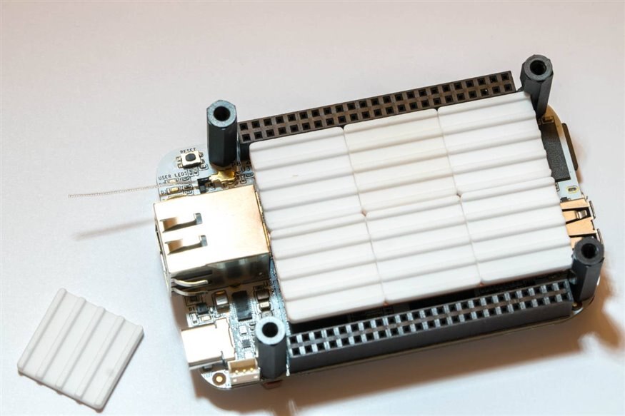

Heatsinking

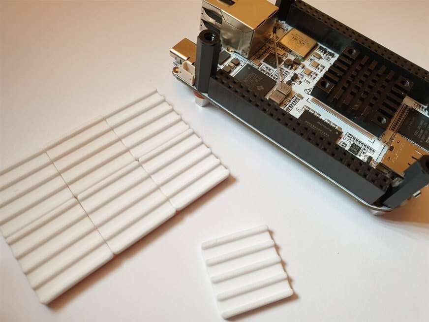

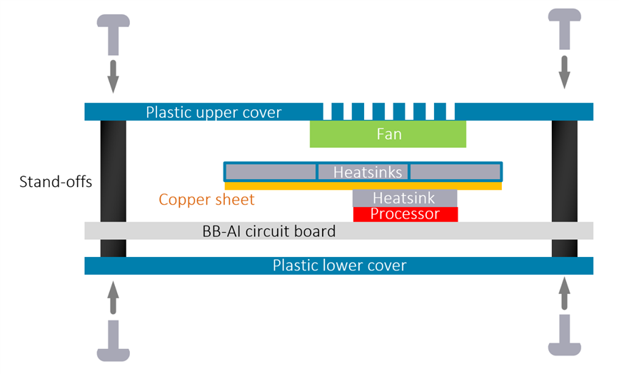

First off, since I was unsure how hot the BB-AI could get, some heatsinking was done. The BB-AI comes with a small heatsink (25x25mm) with M3 screw-holes on a 20x20mm square.
To add more heatsinking, I took a 60x40x1mm copper plate, and stuck on six 20x20x2.5mm ceramic heatsinks20x20x2.5mm ceramic heatsinks (using thermal tapethermal tape). However, micro porous ceramic heatsinksmicro porous ceramic heatsinks would be much better.
It was clamped briefly to make the bond better.
The ceramic heatsinks cannot be easily cut (diamond may work - thanks 14rhb ) so the micro-porous ones may be a better choice for that reason too. 60x40mm is about 2mm too large for the BB-AI - 58x40mm would be ideal : ) Since I could not trim the heatsinks, I dremelled part of the plastic standoffs instead, to accomodate the extra 2mm (you can see the noches on the rightmost plastic stand-offs in the photo above and below). Incidentally the plastic standoffs also need some dremelling at the end, so that they do not hit any components that are nearby on the circuit board.

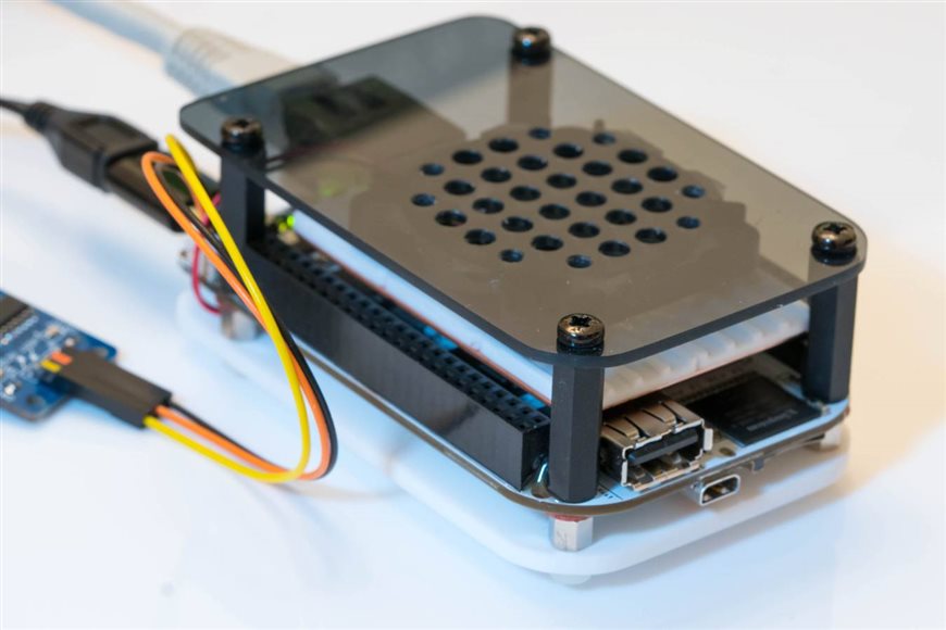

I used 20mm M3 plastic standoffs at the top, and 5mm steel standoffs at the underside, because this is all I had. 25mm (or more) at the top could be better, to allow better access to the 46-way DIL header sockets P8 and P9. As it is, I will probably have to unscrew the top cover to add or remove connections - this isn't ideal, but I can live with it for now, and I could always add extension standoffs later.
Next, the 60x40mm heatsink assembly was stuck on the BB-AI's existing heatsink, using more thermal tape (don't forget to move the antenna on the BB-AI to point outward first! Otherwise it is more awkward to move later).

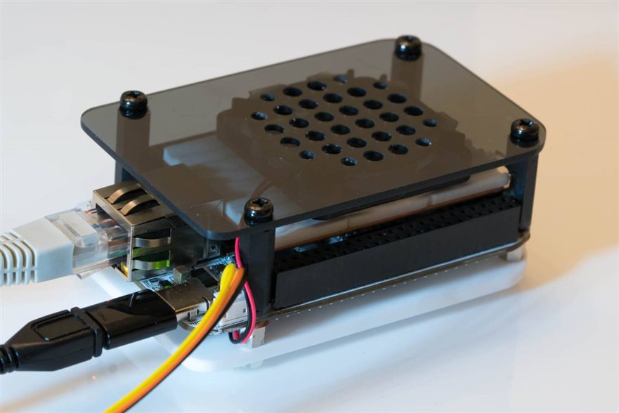

Adding a Fan

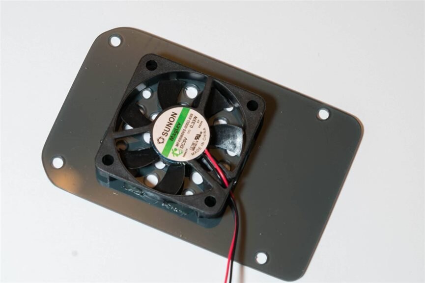

I used the template at BeagleBone AI BB-AI Photos for Documentation Purposes  in order to cut a couple of plastic pieces to fit the BB-AI. The aim was to produce something like this:
A 5V DC 40x40x6mm fan was used - any fan 40x40 or smaller could be used, but it is worth ensuring that the power consumption is low, if you wish to power it from the BB-AI directly.
I stuck the fan onto one of the pieces of plastic (with holes drilled as vents) so that the fan would blow onto the heatsink.

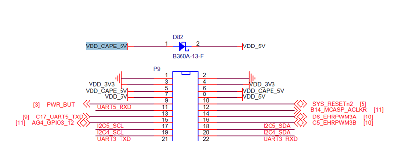

The fan was wired to pins 2 and 8 on the 46-pin connector P9 on the BB-AI (pin 2 is GND, and pin 8 is VDD_5V).
This is the final result:

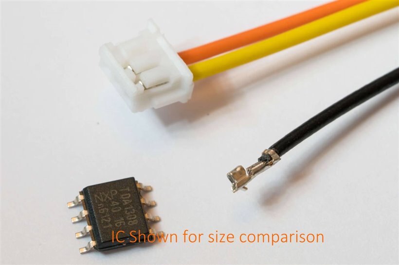

I wanted to have serial access to the BB-AI, for any troubleshooting. The BB-AI has a serial port with 3.3V levels, that can be attached to a PC via a USB-UART adaptor. Terminal software such a PuTTY can be used to access the serial interface. The serial interface is useful as a last resort, because it is always available even in the network (LAN or WLAN) connections fail.
To connect to the 3.3V serial pins on the BB-AI, the required connector body is a 3 way JST ZH3 way JST ZH, along with these  crimp pinscrimp pins.
However the crimp pins are extremely small (photo below shows a 1.27mm pitch IC for comparison). A PA-09 crimp tool can be used, but another option is to buy a connector with pre-attached wires from ebay. Anyway, I preferred to make my own rather than wait for an ebay seller.
The other end can be attached to a 3.3V USB UART to connect to your PC (at 115200 baud - thanks cstanton ).
As shown here, the pinout is:
Pin 1 (closest to the screw-hole on the board, and also marked with a shape on the silkscreen): GND
Pin 2 (orange wire) is UART1_RX which is a BB-AI input pin
Pin 3 (yellow wire) is UART1_TX which is a BB-AI output pin, the BB-AI transmits on this pin
This information is also in the BB-AI System Reference Manual (SRM) online documentation.

    shabaz over 6 years ago in reply to mfetting
    Hi Mike and Clemens,
    There's no SYS_5V on the BB-AI, there is a naming difference in pin designations between the BeagleBone Black and the BeagleBone AI.
    On the BB-AI, this is the pinout:
    Based on this and the BB-AI schematic related to the power area (see below), I picked pin 8 for the fan supply connection, which is a permanent supply. That pin will permanently have power, regardless if power arrives from USB-C, or from a cape with its own power connector. This means that even when the BB-AI is shutdown, the fan will continue running until power is switched off at source, or connector removed. I'm ok with that for now, but its not as good as having a real fan cape with programmable operation.
    The BeagleBone Black pin 8 may do the same thing (I didn't check the PMIC datasheet), but the BBB schematic has named that pin SYS_5V. The BBB VDD_5V pin is not the same pin number as the BB-AI VDD_5V pin. I've used only BB-AI pin names and pin numbering in the blog post.
