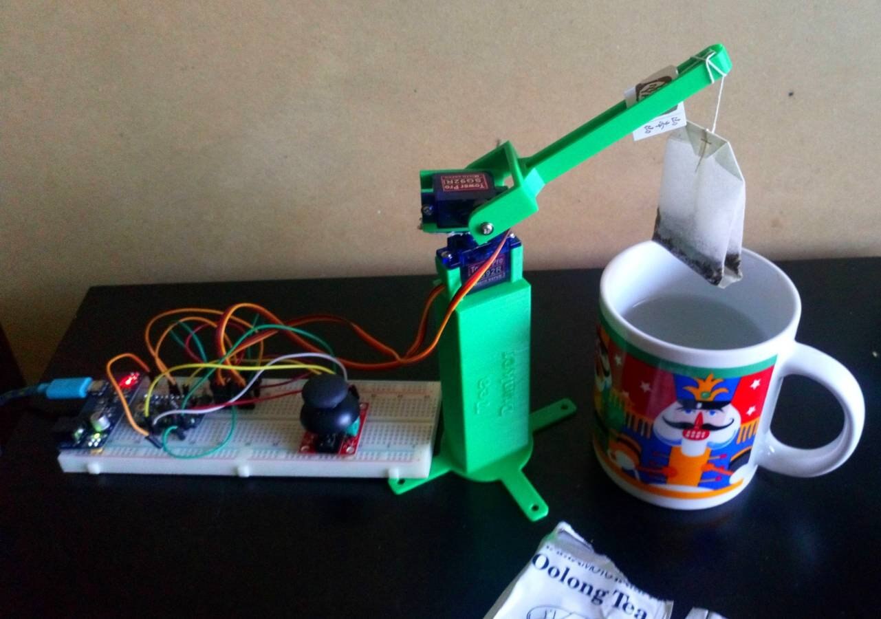

This is my entry to this month Project14 theme - Wacky Automation Devices. For a lack of a better name, I am calling this an Automated Tea Dunker. But if you can come up with something more fun, please leave it in the comment below. Here is the video of the prototype using an Arduino pro mini, two hobby 9G micro servos  and thumb joystick. But I plan to automate this further, if time permits in the coming weeks,  and probably add Wifi capability.
Now if you watched the video and the first thing that crossed your mind was, "hmm, wouldn't it be easier and faster to just dip the tea bag using your hand" image. If yes, then I think I have achieved my goal and build something wacky !!

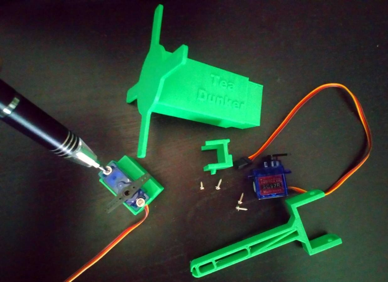

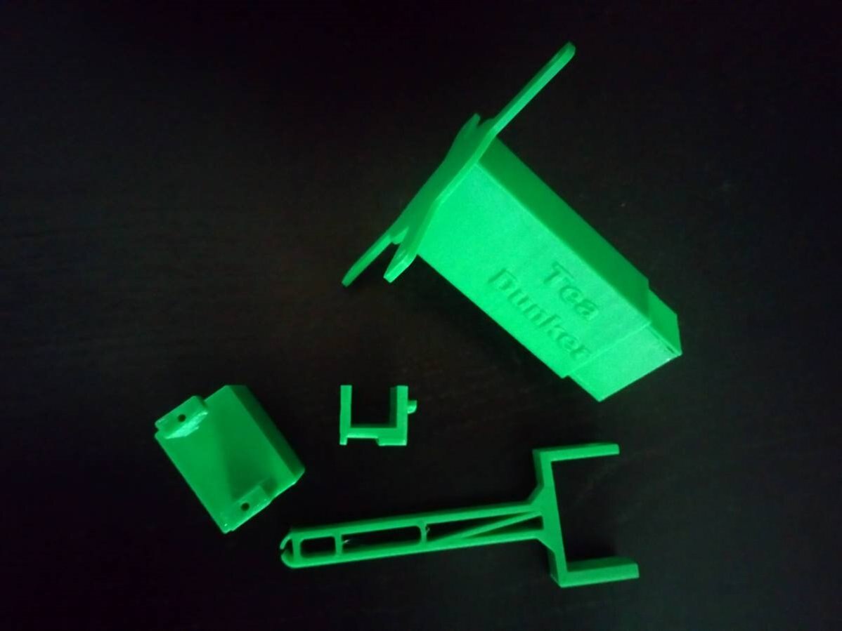

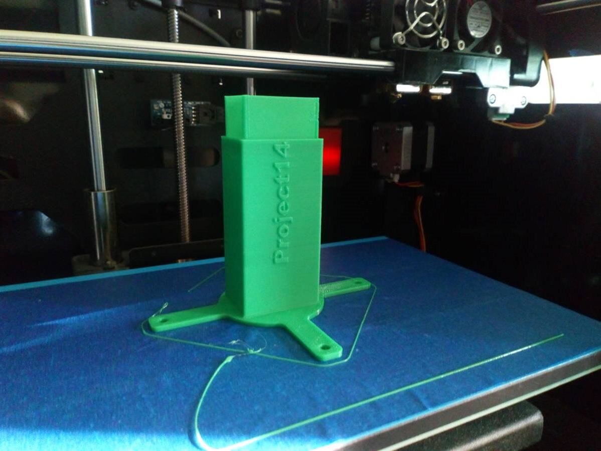

Download and 3D print the STL files attached
There are 4 STL files in total attached in the zip file below, which are going to be used as part of the servo mechanism. You can print this using PLA or ABS filament on your 3D printer.
Here are all the 3D printed parts. In my case, I used Hatchbox 1.75mm green PLA to print the files on my Flashforge creator pro.
Adding the servos to the 3D printed parts
For the servos, I am using two Tower Pro - SG92R servos. The screws used to mount the servo's onto the 3D printed parts should come with the servos.For the base servo, use the two sided servo horn as you see in the picture below. And for the servo that controls the tea bag arm you will have to use a single side horn, here don't completely tighten the screw on the servo horn as you may have to readjust this after uploading the arduino code below, if you are not happy with dunking movement of the tea bag.

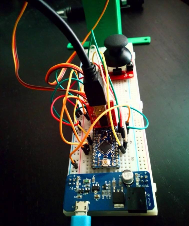

Put the circuit together
As part for the circuit, here are the connections, I am using the Arduino pro mini, but you can use any version of the Arduino..
  • Servo connected to the base 3D printed part is connected to pin#4 on the Arduino Pro mini
  • Servo connected to the tea bag arm is connected pin#5
  • As part of the Joystick the Vertical pot is connected to pin# A0
  • and the Horizontal pot is connected to pin# A1
Upload the code below to the Arduino
In my case, since i am using an Arduino Pro mini, I had to use an FTDI breakout to upload code using the Arduino IDE.

And once you done upload the code, put in the hours of practice !! image and  finally once you confident, dip the tea bag in a cup of hot water and enjoy !!
