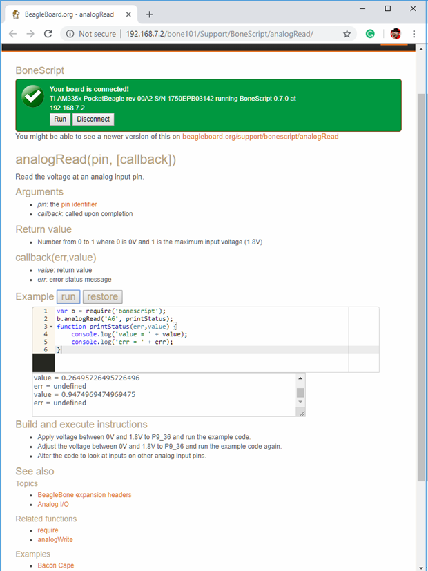

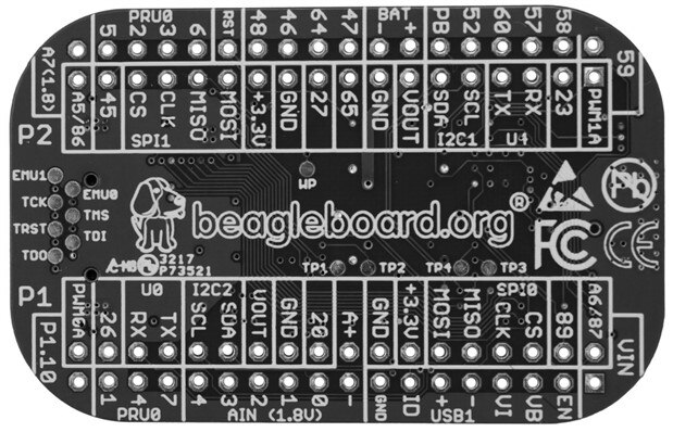

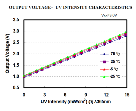

The ML8511 produces an output voltage proportional to the UV level, so I needed to use one of the PocketBeagle's ADC pins to record the level. The PocketBeagle has 6 pins that take 0-1.8v and 2 that can take upto 3v, so I needed to use one of the later pins. The chip also has an "enable" pin which needs to be set high before a reading is taken.

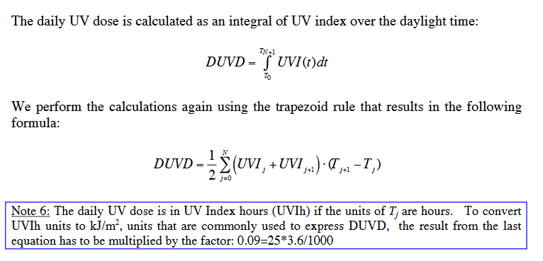

The World Health Organisation have defined a simple index which we can use the determine some colour coded outputs. I was also thinking that the duration of exposure would be significant and the WHO have a second value called the daily UV dose which is calculated as the integral of the UVI over the day.

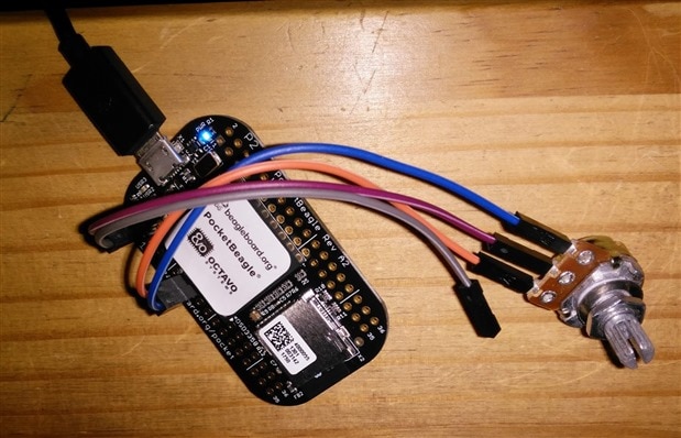

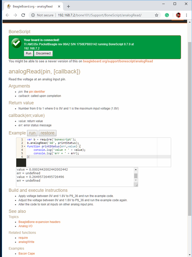

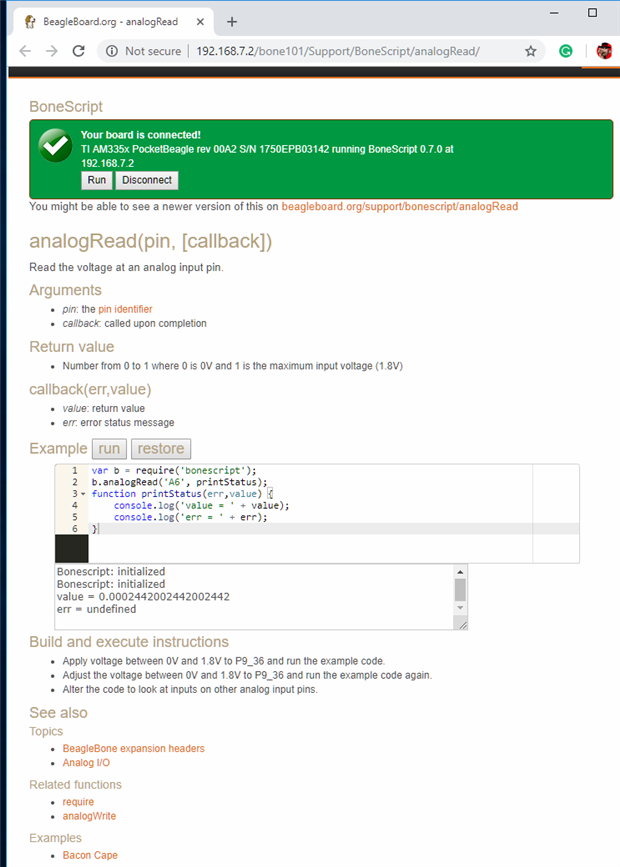

The ADC inputs on the BeagleBones is typically 0 to 1.8v. However the Pocket Beagle Bone has some pins that can cope with 3.3v. One of these is A6. So I attached a potentiometer between 0v and 3.3v and fed it into the A6 pin. So although the documentation does not explicitly mention it, it would appear that the output 0 -> 1 represents voltages 0 -> 3.3v.

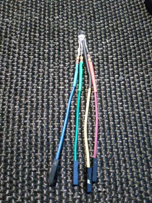

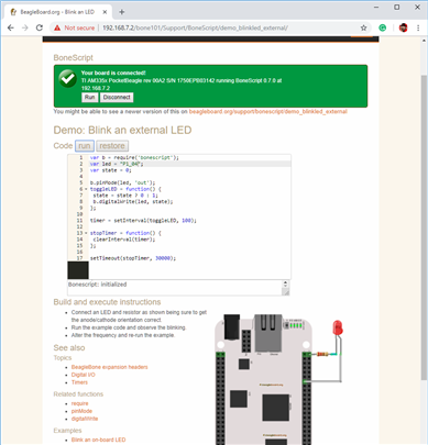

To test the output I wired up an RGB LED as below, and checked it using the blink LED demo to confirm the pin I was using for the enable for the ML8511. This turned out to be P1_04.
The System Reference manual for the Pocket Beagle mentions that it supports "4 Pulse Width Modulation outputs accessible with 2 enabled by default"
I checked with the config-pin command to confirm that the pin P2_3 that I wanted to use was enabled for PWM and it appears to be ok.
https://zeekhuge.me/post/a_handfull_of_commands_and_scripts_to_get_started_with_beagleboneblack/
debian@beaglebone:~$ config-pin -l P2_3
default gpio gpio_pu gpio_pd gpio_input pwm
I wired up PWM1A, PWM0A and GPIO23 to the LED and checked that it could dim these using analogWrite

    Andy, how did you calculate the integral? A math library? Python?

    Workshopshed over 7 years ago in reply to Jan Cumps
    I didn't. Due to time constraints I made it a simple level detector.
    It should be possible to use an array to store all the values and sum them up periodically. But I'm wondering if a rolling average would be a close enough approximation?
