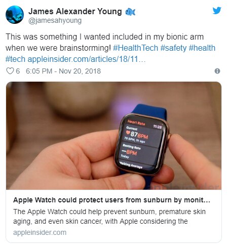

James Young on twitter mentioned that a UV monitor was something he'd find really useful as he has sensitive skin.

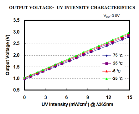

So my thought was to use the PocketBeagle to log the UV exposure using a https://www.element14.com/community/view-product.jspa?fsku=2373588&nsku=NULL&COM=noscriptML8511 chip. It could indicate a warning or send a message to a phone when the levels are too high for too long.

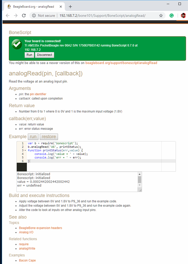

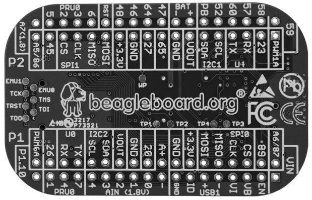

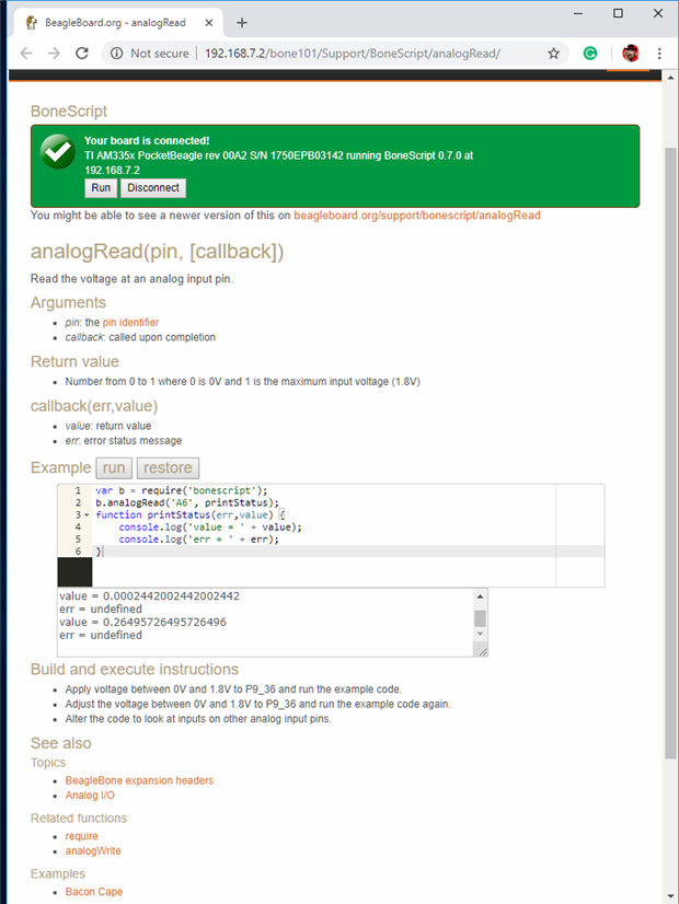

The ML8511 produces an output voltage proportional to the UV level, so I needed to use one of the PocketBeagle's ADC pins to record the level. The PocketBeagle has 6 pins that take 0-1.8v and 2 that can take upto 3v, so I needed to use one of the later pins. The chip also has an "enable" pin which needs to be set high before a reading is taken.

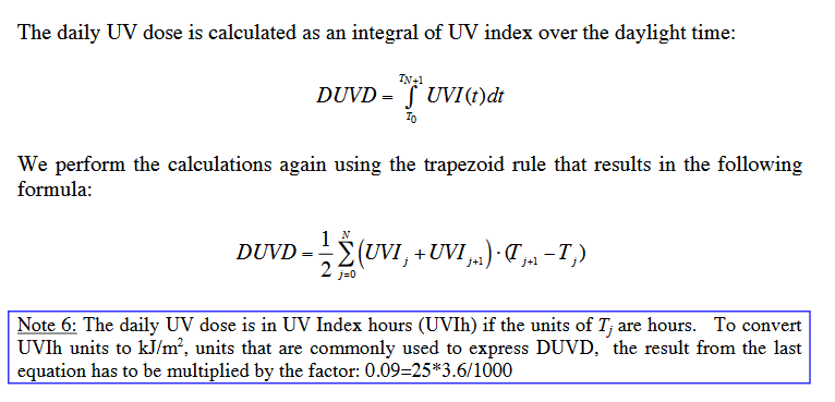

The World Health Organisation have defined a simple index which we can use the determine some colour coded outputs. I was also thinking that the duration of exposure would be significant and the WHO have a second value called the daily UV dose which is calculated as the integral of the UVI over the day.

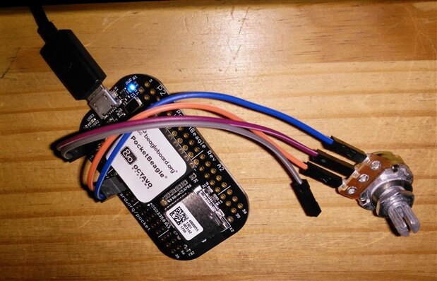

The ADC inputs on the BeagleBones is typically 0 to 1.8v. However the Pocket Beagle Bone has some pins that can cope with 3.3v. One of these is A6. So I attached a potentiometer between 0v and 3.3v and fed it into the A6 pin. So although the documentation does not explicitly mention it, it would appear that the output 0 -> 1 represents voltages 0 -> 3.3v.

Testing: Wiring up a potentiometer to check the A6 input
Test 1: Floating
Test 2: 1v
Test 3: 3,3v

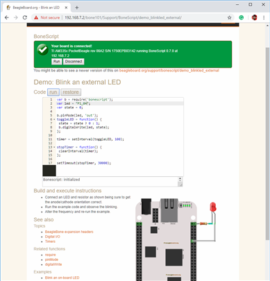

To test the output I wired up an RGB LED as below, and checked it using the blink LED demo to confirm the pin I was using for the enable for the ML8511. This turned out to be P1_04.
The System Reference manual for the Pocket Beagle mentions that it supports "4 Pulse Width Modulation outputs accessible with 2 enabled by default"
I checked with the config-pin command to confirm that the pin P2_3 that I wanted to use was enabled for PWM and it appears to be ok.

    Andy, how did you calculate the integral? A math library? Python?
