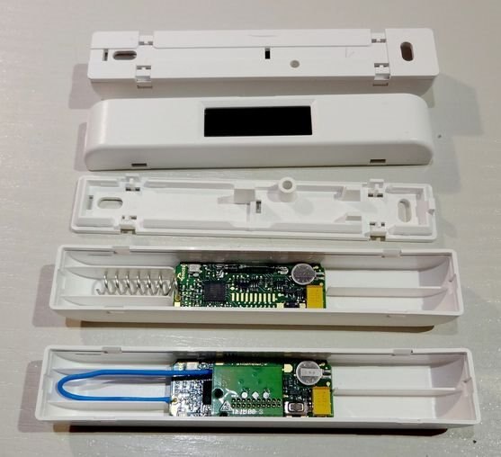

EnOcean was so kind to send me enclosures for all of them (and one for the STM330, and one HSM100 sensor), so the problem of mounting them is now solved. And it looks much better, which increases the wife-acceptance-factor image
From top to bottom:
  • a case with the bottom lid closed (so its ready to be mounted)
  • a case from the top side, with just the solar cell visible
  • a lid - the stud in the middle holds the PCB in place, and the small hole beneath id allows to press the button (on the STM330 at least)
  • the STM310 contact sensor in the case - there is extra room for the antenna
  • the STM330 temperature and humidity sensor in the case - here the lid will not fit without modification

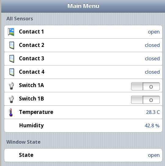

Having this rule in place, and waiting for OpenHAB to reload all changes, the main window ends up in (with all but one contact closed):
