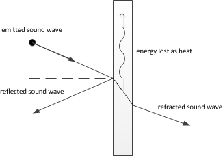

Imagine a point source that emits sound waves. As the waves are produced from the source, they propagate by vibration of particles in a medium (for example open air).
If a sound wave strikes a flexible object, a portion of the total energy will be reflected and another part will be transferred into a vibration of the object (absorption).
Some energy (heat) will be lost as the wave travels through the object and encounters friction from the material. Sound waves travel faster in a dense medium, thus the sound will be refracted by its encounter with a solid object. This is illustrated in the following figure:

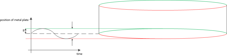

Imagine we take a flexible plate and apply a sound wave to it. As the sound wave travels through the plate it will vibrate resulting in a slight flexing. The next figure shows an exaggerated example of this. Imagine we observe the position of the plate (by position we mean the nearest point on any part of the plate) from a certain point. If no sound wave is applied, the distance between the plate and the observation point is equal to A. In the second situation a sound wave strikes the plate and the plate flexes slightly inward. From our observation point, the distance of the plate is now equal to C. The difference between the original idle position of the plate and the flexed position is exactly B. In the third situation, the plate flexes back to the other side. This results in a new relative position which is equal to D. This is exactly equal to the original idle position plus B or C plus two times B.
The relative position of the plate can be plotted versus time as shown on the following figure:

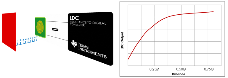

The dynamic range of the microphone tells us what the minimum and maximum amplitude of the vibration is we can detect. There are also various parameters that will determine what the dynamic range of the LDC1000 <-> transducer combination will be including the distance of the transducer, the construction of the coil, RP_min and RP_max.
The main advantages of using the LDC1000 are the high sensitivity and dynamic range and the fact that it has a digital output. Since the LDC1000 only requires a coil and a conductive target, there are also no rare-earth magnets required. I do expect some difficulties as the basic setup shows that the LDC output is not linear for a basic position measurement (see figure).

    Very interesting project. Good idea, I'm curious what it will sound like, and whether you'll be able to callibrate for the non-linearity. On the other hand, the amount of displacement will be so small that I wonder whether you'll notice the nonlinearity over that small excitation.
    I like this project. I think it should be possible to mount a piece of metal with something like silicone glue on a background. It should allow it to vibrate enough to be picked up by the LDC1000.
    e14 Contributor over 12 years ago in reply to DAB
    That is a good idea. My initial idea was quite similar: to use a cardboard tube with some stretched aluminum foil at one end. Like you say it'll be a matter of adjusting the LDC and the distance between the coil and metal to get a good detection.
    e14 Contributor over 12 years ago in reply to dougw
    Hi Douglas,
    Yes I had thought of that, but I'm not quite sure how I'll eventually mount the transducer or even what shape it will have. Like DAB said I will probably start with a stretched piece of plastic or aluminum foil on some container (I was thinking about using a piece of cardboard tube, not sure what the resonance frequency would be). I had also thought of trying something like a ribbon mic, where you use a corrugated piece of metal to detect vibrations. Anyway, the mounting structure will certainly have an influence on the frequency response. I will keep your remarks in mind when building a prototype, thanks!
    DAB over 12 years ago in reply to e14 Contributor
    Just keep it simple, take a sheet of plastic food wrap and then attack a small piece of metal tape.
    Use an old plastic bowl and drill some holes in one end and attach the plastic wrap to the opening with some tape.
    Then you adjust the LDC detector until you can see detection as you blow into the other side of the bowl.
