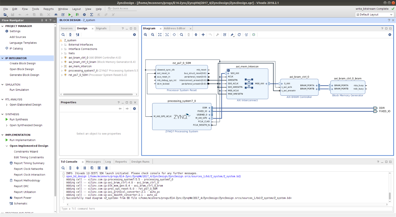

If you look at some of my earlier blogs, you may remember that the above diagram only contained the ZYNQ7 Processing System. In the lab we added the Reset Block, the AXI Interconnect, the BRAM Controller, and the Block Memory Generator. It's a lot of steps so I won't go through them here, but it's not a difficult process to add each of the components. I did not have to draw the interconnect lines, it did that when I added each of the blocks. So that was nice. It also took care of arranging the blocks for me.

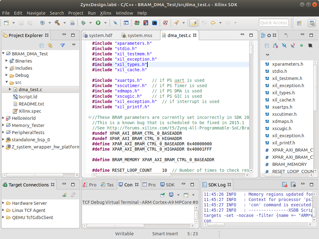

The above is a screenshot of the SDK. They had a pre written program to exercise the Block Memory they had us add. We did make use of a new button this time. Right below the help link, there is a button with a red arrow and 3 green boxes. We clicked on that to program the FPGA. After that we hooked up the console below. Flashed the processor, and exercised the newly added IP.

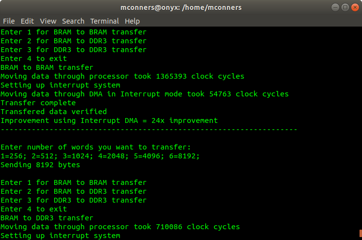

In the above example, I had chosen an 8192 block size for a DMA transfer of BRAM to BRAM, which resulted in 24x improvement over having the CPU copy the data.

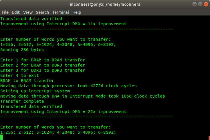

The above screen capture is more of the same. I pretty much tried all the combinations.
