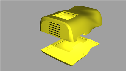

A special case

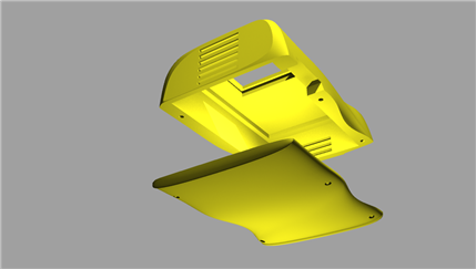

The position and motion sensors information from the SenseHATSenseHAT on the Raspberry PI3Raspberry PI3 together with the RGB 8x8 display are  the perfect tool to make the controller interactive interface for IoT project.
Making the device easy to control by any kind of user the hardware needs a case. The form design and the impacting bright yellow colour harmonise with the site where the installation will be set in place; it is also an easily identifiable object by visually-impaired users.
The following images shows the rendered design of the case hosting the PI3 and SenseHAT
The design has been split in two halves to include the hardware elements as shown below:
Top and bottom parts will be fixed with 4 Parker screws. Based on the first tests the internal air circulation should be sufficient for Raspberry PI3 cooling.

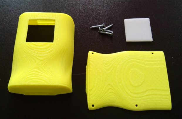

3d printing and assemblilng

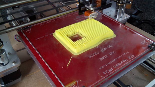

The 3D printing operation requires about 5 hrs total with a 0.4mm nozzle and a layer thickness of 0.2mm The case will not be stressed mechanically so it is sufficient setting the internal fill to 25% with a 0.6 thickness to the sides. As shown in the above image most of the time required depends on the need of a full internal support of the empty spaces.

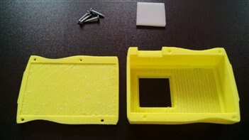

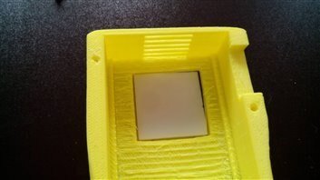

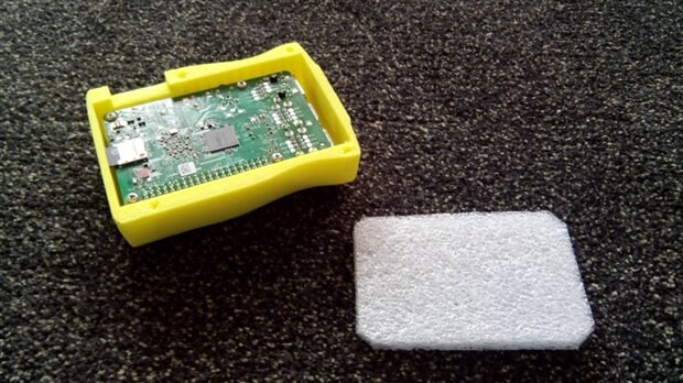

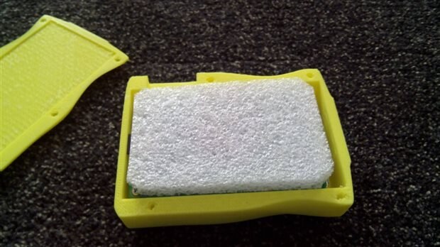

The above image shows the "kit" components ready for assembling; note the the open window for the SenseHAT LCD will be sealed with a 2mm opaline acrylic frame: this generates a nice effect for the display readability. The internal hardware does not need to be fixed with screws but a 5mm antistatic foam bed is sufficient, pressing the internal assembly when the screws are closed.
{gallery} Assembly steps
The components ready for assembly
The top side with the Raspberry PI3 fit in place.
The case ready to be closed

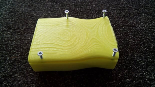

Closing the case with the four screws

    Awesome design !! And also love the idea of using the piece foam to diffuse the LED matrix on the sense hat..
