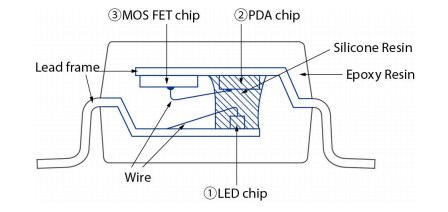

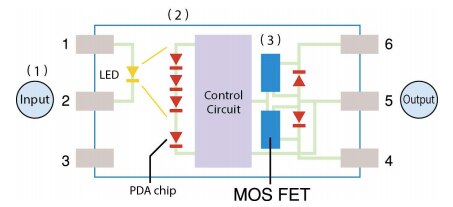

MOSFET Relay Block DiagramMOSFET Relay Construction

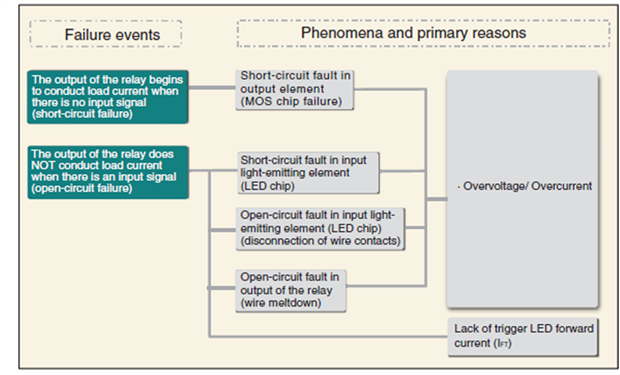

What is the failure mode, if there is ESD or overvoltage/overcurrent on the switched side,
See failure criteria below.  Please provide more details from the actual design and we can provide recommendations!

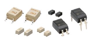

Hi Gabriel, my first question is why some of Omron mosfet relays are white and some are black plastic?
White plastic mold creates better MOSFET relay sensitivity and allows lower power consumption on LED side.

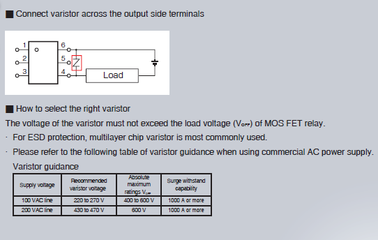

Is there any ESD protection for the MOSFET relays?
To prevent ESD - Electrostatic Discharge, using a varistor can be effective method. Please use protection device whose operation time is faster than the time to be applied Overvoltage to MOS FET.
