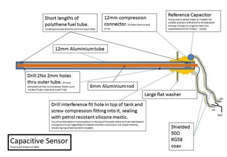

    the-dubster over 10 years ago in reply to phoenixcomm
    Cristina Harrison wrote:
    BTWimage
    Capacitive sensors take advantage of the geometry of the flat capacitor
    NOT TRUE! Please look at a fuel sensor in aircraft:
    Cris
    You'd have thought I'd have picked up on that considering where and what I teach . . . . . . . .
    We've been using capacitive cells for decades on aircraft - I just never actually thought about it!

    BTWimage
    Cris
