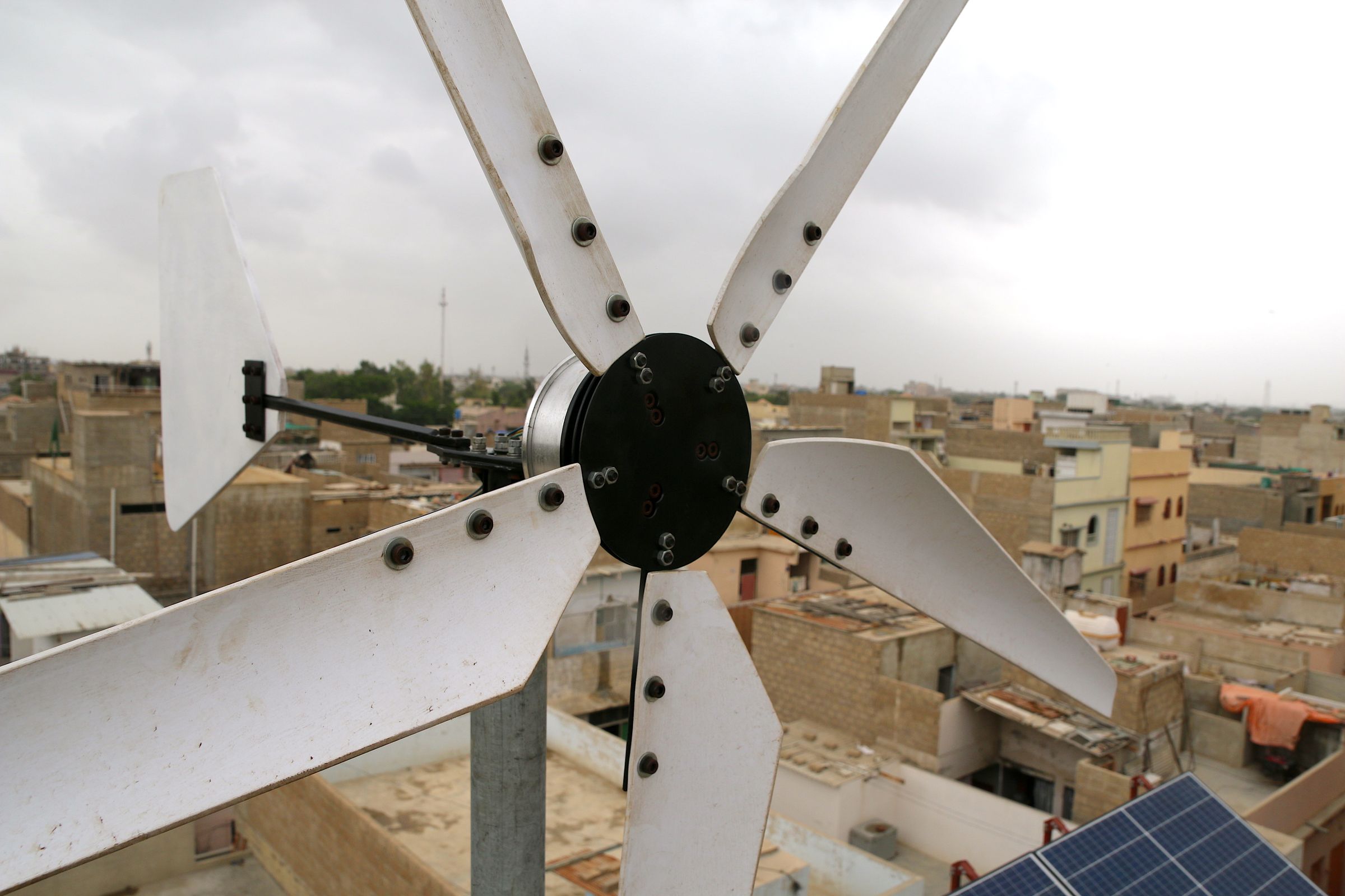

Depending on the motor you use, you may also need a buck-boost converter to get the desired voltage. Various DC motors salvaged from old devices can work as generators, as well as an alternator from a car. This tutorial makes use of an old hoverboard.
diagram 6
Figure 6: A Micro Wind Turbine Image Source: https://content.instructables.com
Now the fun part: cobbling together a windmill structure from pieces you can find at the local hardware store! Materials you’ll need:
  • PVC pipes: Get a length of PVC pipe for the turbine blades and another for the tower.
  • Steel pipe or metal rod: This will serve as the turbine shaft.
  • Wooden board or base to mount the turbine.
  • Wires and connectors
  • Screws, nuts, and bolts: For assembling the components.
You’ll also need a battery to store the generated electricity. Larger projects might require a wind turbine charge controller to prevent overcharging of the battery.
  • Design the blades: Determine the size and shape of the blades. The most common design is a simple flat or curved shape. Cut the PVC pipe into three or four equal-length pieces and shape them into blades using appropriate tools.
  • Build the turbine hub: Drill a hole through the center of a small PVC cap that fits the motor shaft. Make sure it's tightly secured to the motor shaft.
  • Construct the tower: Attach the PVC pipe for the tower vertically onto the wooden board or base. You can reinforce it with additional supports or a tripod if desired.
  • Attach the blades: Connect the blades to the hub. You can use screws or epoxy to secure them in place, ensuring they are evenly spaced.
  • Mount the motor and hub: Fix the motor and hub assembly to the top end of the tower using screws, ensuring the motor is facing the wind direction.
  • Connect the wires: This step depends on the type of motor you are using. For a brushed DC motor, connect the output of the motor to the battery. For a BLDC, the output of the motor is connected to a 3-phase
  • rectifier, then the battery.
  • Test the turbine: Place the turbine in a location with a steady breeze or use a fan to simulate wind.
