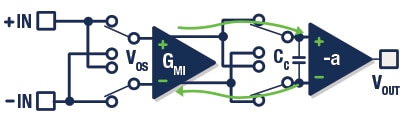

Zero-drift amplifiers employ a unique, self-correcting technology which provides ultra-low input offset voltage (VOS) and near-zero input offset voltage drift over time and temperature (dVOS/dT) suitable for general and precision applications. TI’s zero-drift topology also delivers other advantages, including no 1/f noise, low broadband noise, and low distortion – simplifying development complexity and reducing cost. This may be done two ways: using a chopper amplifier or via autozeroing.
Zero-drift amplifiers are suitable for a wide variety of general-purpose and precision applications that benefit from stability in the signal path. The excellent offset and drift performance of these amplifiers make them especially useful early in the signal path, where high gain configurations and interfacing with micro-volt signals are common. Applications that benefit from this technology include precision strain gauge and weight scales, current shunt measurement, thermocouple-, thermopile-, and bridge-sensor interfaces.

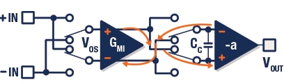

Chopping zero-drift amplifiers' internal structure can have as many stages as continuous-time amplifiers. The main difference is that the input and output of the first stage has a set of switches which inverts the input signal every calibration cycle. Figure 1a shows the first half cycle. In the first half cycle, both sets of switches are configured to flip the input signal twice, but the offset flips once. This keeps the input signal in phase but the offset error polarity is reversed.
diagram 1a
Figure 1a: First Half Cycle
diagram 1b
Figure 1b: Second Half Cycle
Figure 1b shows the second half cycle. Here, both sets of switches are configured to pass the signal and offset error through unaltered. Effectively, the input signal is never out of phase, remaining unchanged from end to end. Since the offset error from the first clock phase and second clock phase are opposite in polarity, the error is averaged to zero.

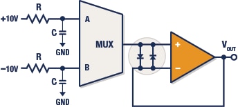

A multiplexer (MUX) works as a switch in a data acquisition system to connect a selected channel of input to a single data converter. A precision amplifier is placed after a multiplexer to drive the analog to digital converter precisely and to ensure accurate processing. Since the output of the op-amp does not change rapidly, a large voltage appears at the input of the op-amp. To respond to this condition, anti-parallel diodes are added to protect against a sharp increase in the input bias current. Refer to Figure 2a.
diagram 2a
Figure 2a: MUX with Buffer-Configured Op Amp

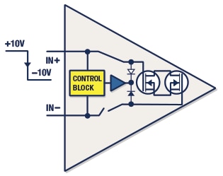

diagram 2b
Figure 2b: MUX-friendly Scheme (High to Low Input Step)
But the anti-parallel diodes are not required in a new 36-V CMOS input circuitry design by Texas Instruments. These MUX-friendly amplifiers are still able to maintain the same level of protection and robustness while also improving settling time for switched systems. This patented input protection scheme uses a set of internal switches which open and close to protect the input of the op amp when large voltage steps are applied. This protection scheme has the added benefit of no inrush current. When the positive input goes low (+10 V to –10 V), the control block opens the switch at the inverting terminal (IN-) and activates one of the diodes. When the positive input goes high (–10 V to 10 V), the control block opens the switch at the noninverting terminal (IN+) and activates the other diode. Refer to Figure 2b.
OPA189 and OPA2189 are examples of MUX-Friendly precision high voltage op-amps used in the application of high-resolution ADC driver amplifiers, high voltage multiplexed data-acquisition systems, high precision comparators, and test and measurement equipment.
The TMUX6104 is a complementary metaloxide semiconductor (CMOS) analog multiplexer for use in high precision measurement applications. It has very low on and off leakage currents and ultra-low charge injection. It also provides excellent isolation capability by blocking signal levels up to the supplies when the switches are in the OFF position. A low supply current of 17 μA enables usage in portable applications.

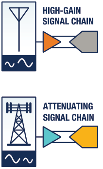

diagram 5
Figure 5: High Gain versus Attenuating Signal Chains
Data-acquisition systems and digitizer front-ends are often paired with high-sensitivity sensors that produce low-level output signals (i.e., measuring the voltage drop across a low-resistance shunt to measure the current in the circuit). In such cases, the amplifier signal chains are configured in high gains to maximize the dynamic range of the ADC. High-precision, differential input ADCs are typically limited to a maximum recommended supply of 5 V and a corresponding maximum differential input range of 10 VPP when the reference voltage (VREF) is set to 5 V.
However, in high-power industrial signal chains, the input signal to the system can be much larger, in which case the amplifier signal chain must attenuate the signal input down to the acceptable input range of the ADC. Figure 5 shows a simple illustration of the difference between a low signal input and high signal input ADC front end.
To design a system for this type of signal chain, some important factors such as bandwidth, slew rate, distortion, and power should be considered. For example, a high power industrial data acquisition system that requires high input impedance, low input bias current, and a rail-to-rail input and output can be designed with a high voltage op-amp such as the OPA2810. It is a dual-channel, FET-input, voltage feedback operational amplifier with low input bias current, a high supply range of 27V, and high gain bandwidth product of 70 MHz. It’s commonly used in a buffer configuration in front of the differential amplifier. The OPA2810 is unity-gain stable with a small-signal unity-gain bandwidth of 105 MHz, and offers excellent DC precision and dynamic AC performance at a low quiescent current (IQ) of 3.6 mA per channel (typical). Figure 6 illustrates the high input impedance signal chain using the OPA2810.

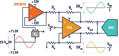

Diagram 7
Figure 6: High Impedance Signal Chain with High Voltage Op Amp Buffer Stage
For this type of signal chain, Table 1 shows the attenuation needed in the FDA stage based on the input signal and the 5-V maximum allowed ADC input, and the common-mode input swing the FDA must support. VREF is assumed to be 5 V and hence VOCM is set at 2.5 V.
HIGH-Z BUFFER INPUT SIGNAL SWING ATTENTUATION (RF/RG) VIN_CM VIN_CM SWING
OPA2810 -11.5V to +11.5V 5V / 11.5V to 0.44V 1.96VDC ± 1.74V 0.22 to 3.7V
Table 1: Attenuation Needed in FDA Buffer Stage

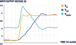

Figure 9 shows the output voltage and input differential voltage when applying an 8V step at the noninverting input of the OPA2810 configured as a unity-gain buffer.
diagram 9
Figure 9: Large-signal transient response using a fast settling amplifier
Because of the fast input transient, the amplifier is slew-limited and the inputs cease to track each other (a maximum VIN,Diff of 7V is seen Figure 9) until the output reaches its final value and the negative feedback loop is closed. For standard amplifiers with a 0.7-1.5V VIN,Diff rating, you must use current-limiting resistors in series with the input pins to protect from irreversible damage, which also limits the device frequency response. The OPA2810 has in-built input clamps that allow the application of as much as 7V of VIN,Diff, with no need for external resistors and no damage to the device or a shift in performance specifications. Such an input-stage architecture, coupled with its fast settling performance, makes the OPA2810 a good fit for multichannel sensor multiplexed systems.
