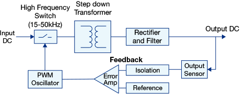

The electricity we use in our homes and office buildings is commercial "mains" AC power sourced from the electricity grid generated at centralized power plants. However, the AC voltage cannot directly operate the integrated circuits and electronic components used within office equipment, factory automation equipment, and other consumer electronic devices. Stable DC voltages are necessary to operate these devices and integrated circuits. A regulated DC power supply is a device that converts commercial AC to regulated DC power.
automation 3 diagram 1
Figure 1: Power Supply Block Diagram
Power supplies can be separated into two broad categories: Switch-Mode Power Supplies (SMPSs) and Linear Regulated Power Supplies (LPSs). An LPS initially transforms high AC voltage to low AC voltage, which is then rectified. The output voltage is regulated by relinquishing excess voltage.
A switch-mode power supply (SMPS) employs semiconductor switching techniques, and is more complex than a linear power supply. An SMPS receives commercial AC power at its input and uses a high-frequency power switching stage and a control circuit. It shifts between fully ON and entirely OFF states at an extremely high frequency. The power switching stage performs the power conversion from the circuit's input voltage to its output voltage, including output filtering. The switch-mode operation ensures a regulated DC supply output, and is more efficient for a prescribed size, weight, and power unit cost.

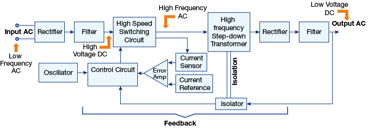

- 4.1 The Basic Operation of an SMPS
An SMPS maintains a constant output independent of load variations. It can buck, boost, or buck-boost the output voltage, which makes it superior to linear regulators, which can only decrease or buck the output voltage.
automation3 diagram 2
Figure 2: Block Diagram of an SMPS
Figure 2 illustrates how an SMPS functions. In the first stage, the input AC power is applied to the rectifier and input filtering to generate DC power. The second stage sees the SMPS working at high frequencies. The high-frequency switch enables a high-frequency pulsating DC signal. The SMPS switching regulators continuously alternate between on and off states. The high dissipation state, which reduces system power dissipation, takes minimal time. In the third stage the power transformer steps down the voltage. The stepped-down signal is subsequently rectified and then filtered to provide a constant, steady DC output. The control circuitry maintains a steady output of the desired voltage level.
