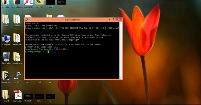

Step2: Download putty. It is a small softwae that lets you establish an SSH connection.Run putty and type this IP address of your pi in the host name under the sessions. and click open
Then login using login ID and password. Default is pi and raspberry respectively.

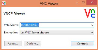

Step6: Install a VNC client like the real VNC view https://www.realvnc.com/download/viewer/
Step7: open putty enter the host IP(the ip of raspberrypi) in the host field under sessions. Then go to tunnels under the SSH tab.add source to be 5901 and destination to be hostIP:5901. then click add.Finally  click open.
Step 8: log in into the pi using putty
step9: Open real VNC  view. Under the VNC server name add localhost:5901. click connect. then click continue on the next popup.
After this you will be prompted for password. Enter password that you have setup while setting up the vnc server and you will get the screen of your Pi.
