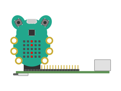

Before we get started on this project we will need to make sure we have followed the 10 CodeBug Projects in 10 Days: Raspberry Pi Controlled CodeBug with I2C project.  We'll also need to make sure to have the CodeBug connected in the correct position on the Raspberry Pi's GPIO before attempting this project.
NEVER connect the Micro USB or use a battery with CodeBug while it is fitted to a Raspberry Pi.
We can create some amazing projects, by controlling the CodeBug with Python using the Raspberry Pi’s I2C port.
