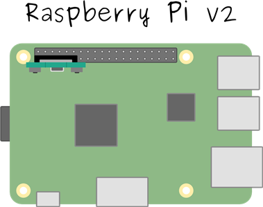

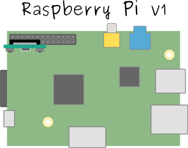

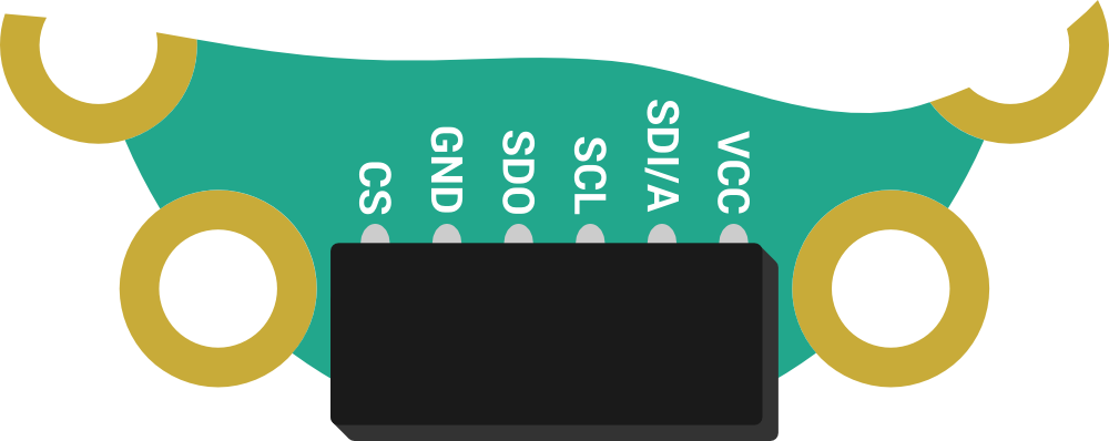

Next we will need to fit the CodeBug onto the Raspberry Pi. CodeBug connects straight to Raspberry Pi's GPIO header through CodeBug''s expansion connector. While the Pi is diconnected from power, align CodeBug to the pins shown in the diagrams below and gently push CodeBug's connector onto the GPIO pins. Make sure to NEVER connect the Micro USB or use a battery with CodeBug while it is fitted to a Raspberry Pi.
Make sure you select the appropriate Raspberry Pi model, the Raspberry Pi expanded its GPIO header from 26 pins to 40  with the Raspberry Pi Model B+
If you are still unsure which Raspberry Pi GPIO pins to connect CodeBug to, note the pin labels on the back of CodeBug, and connect these to the corresponding pins on your Raspberry Pi.
