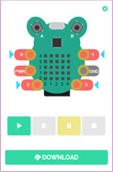

To set the Legs of the CodeBug we will need to first configure the Emulator. To do this we will need to open the emulator configuration via the settings cog on the emulator. Tick the Show Leg Controls box. Click on the Configure Emulator button to complete the settings change. The emulator will now show the status of the CodeBug's legs with blue arrows. The arrow pointing into the legs denotes that it's set as an Input; away from the legs is an Output. When the background of the leg is red, the leg is at Power, when the leg is black, it is Ground.

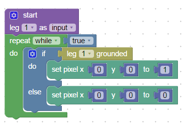

Now that the Emulator has been configured, we can begin programming the legs. To do this we will need to click on the Cog of the Start block. From the popup we can drag the Leg Input/Output block into the Start block on the right. Because we want the Leg to sense a button, we will need to tell CodeBug to use Leg 1 as an Input. .

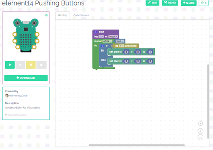

We want CodeBug to run different code depending on whether a button is pressed. In order to do this we will need an If block and a block that checks to see if the Leg is connected to Ground via the button.  We will start by dragging in an If Else block and placing it in an empty space on the workstation. From the Input/Output menu we will drag a Leg Grounded block.
We will need different code to run when the button is pressed. If it is pressed we should get a Set Pixel block to turn the LED display on, and a Set Pixel block to turn it off. To do this we we need to take two Set Pixel blocks from the 5X5 Display menu. Next we will snap them both inside the If Else block, one under If and the other under Else. We will set the Else section to 0. We will want this code to repeat so we will need to add a Repeat While True loop and snap it into the Start block. Finally we will drag in the code into the Repeat While True loop.
Now it's time to see if it works via the Emulator...
With the program working we can now send that over to the CodeBug.
With the code working, click on Download; it's just under the emulator controls. When the code downloads, plug a USB to micro USB cable into your computer. While holding Button A of your CodeBug also insert the micro USB into the CodeBug. The top left LED in the matrix on the CodeBug will flash. Your computer should also recognize the CodeBug as a USB drive on your computer. Copy the downloaded code from the CodeBug website to the USB drive and run the program by pressing Button B. If your CodeBug is on battery power, you can now disconnect the USB cable.
