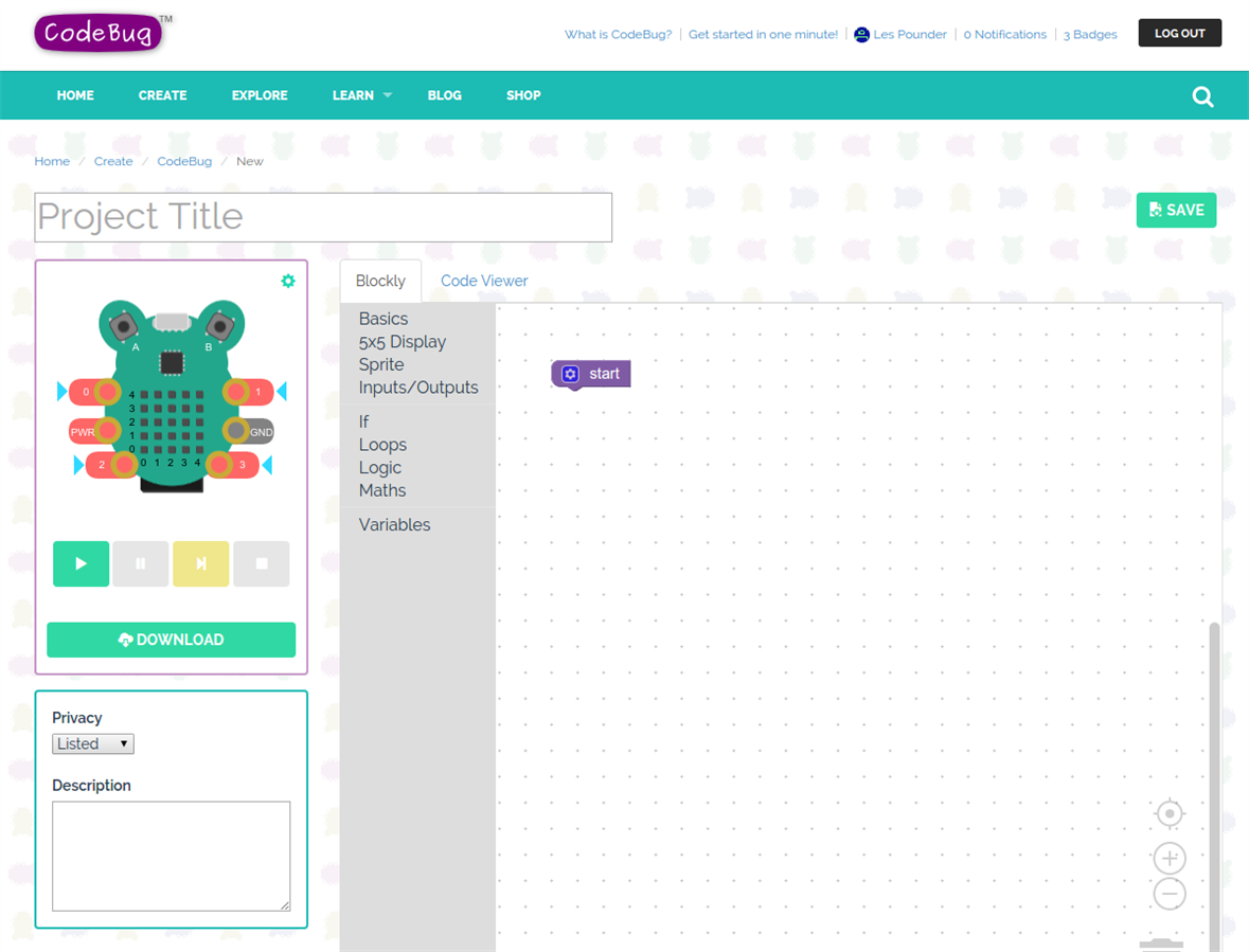

We start coding by creating a new project at codebug.org.uk
We then see a blank project appear on screen. It is good practice to name your project and regularly save it.
We’ll start coding by editing the start block, click on the cog to open the config options. We need to configure the block so that it has four leg input/output blocks, one for each of the legs we wish to configure. Drag them from the left of the popup so that they are inside the start block. When done click on cog to close the options.
