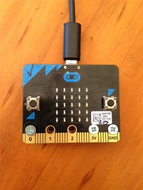

Updated 9/21/2016 to include an image and Bluez/BLE setup instructions for Raspbian "Jessie" on Raspberry Pi 3.
Oh deary dear...this is not what I wanted to do on a Thursday afternoon.
Some background:
I recently won an opportunity to build an "alert button" project using a Micro:Bit and a Raspberry Pi (thanks again, element14!). The Micro:Bit will be shipping soon, and the Raspberry Pi (not supplied by element14) is sitting in my office humming very warmly under a table, waiting to be put to work.
Coincidentally, a Mini Maker Faire took place last weekend in my city, and one of the workshops at the event was about Micro:Bits. I made sure I was first in line, and lucky me, the first 20 people got a free Micro:Bit. That was a very nice surprise! So, all week I've been playing around with a Micro:Bit while I wait for the element14 Micro:Bit to arrive.
Communication between a Micro:Bit and my Raspberry Pi is central to my project. Both devices support Bluetooth Low Energy (BLE), so I figured I'd be in good shape communication-wise. What I didn't consider was how well BLE is supported on Raspbian, which is the version of Linux running on the Raspberry Pi. And by "how well BLE is supported," I actually mean "how little BLE is supported." In fact, I'm pretty sure there is no distribution of Linux for Raspberry Pis that supports BLE out of the box. BLE support is experimental at best, and you can't even get the experimental support without replacing a tricky software package/suite called "Bluez". The version of Bluez in the latest Raspbian (Linux on Raspberry Pi) is 5.23, but you need at least version 5.40 to get BLE. And folks, let me tell you, this is one BEAR of a package to replace. It's ugly, very ugly, and even when it's installed and allegedly running it does not always work as expected. To make things even more fun, there are many forums and webpages that discuss upgrading Bluez, but none of them describes 100% of the process.
I managed to upgrade Bluez today. I took detailed notes as I upgraded, and they are shared below. The problem is, like anything that sporadically works on Linux, good instructions can get you 95% of the way to a solution but that last 5% is going to resemble throwing spaghetti at a wall. Maybe that's why none of the online help takes you 100% of the way toward a solution? Once the software is installed and running, nothing short of a series of random power on/off cycles, scan sessions, connect and pairing attempts, reboots, etc will get the Micro:Bit seen and paired. Once paired, the pairing seems to stick at least for a while. Sometimes the pairing mysteriously drops and the process begins again. And even when the Micro:Bit is paired and connected, experimenting with its GATT attributes is sometimes effective, sometimes not so effective. After a few hours of experimenting, I felt like a caveman banging two rocks together trying to get them to talk.
Anyway, here are the steps and/or commands that I executed to get Bluez/BLE set up on my Raspberry Pi so my Micro:Bit could at least pair and connect to it:

You may want to play with gatttool at some point. It is part of Bluez and is built in the make step above, but it is not installed by default. You will need to manually install it (optional):
sudo cp attrib/gatttool /usr/local/bin
Enable experimental support in the bluetooth daemon (this enables BLE). Put this all on a single command line:
sudo sed -i '/^ExecStart.*bluetoothd\s*$/ s/$/ --experimental/' /lib/systemd/system/bluetooth.service
Raspbian installs bluetooth firmware in directory not recognized by Bluez, so make a symbolic link (it's like a Windows alias) that references the firmware directory in the location Bluez expects it to be in (/etc/firmware):
sudo ln -s /lib/firmware /etc/firmware
Now, enable bluetooth to load during system boot, then reload daemons to load it without rebooting, or just reboot after enabling it.
sudo systemctl enable bluetooth
sudo systemctl daemon-reload
The following seems to be needed every time the Raspberry Pi boots. This should go in a startup script somewhere, but I have not figured out which one yet. For now, every time the Raspberry Pi reboots, just run this command:
/usr/bin/hciattach /dev/ttyAMA0 bcm43xx 921600 noflow -
