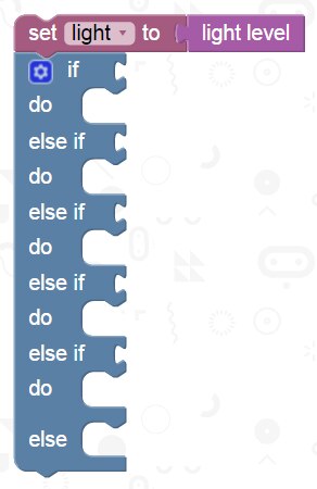

  • Create a new variable called 'light' and set it to the input 'light level'
  • In the first instance, we're going to write a code that makes the LED array increase or decrease in brightness in relation to the intensity of light the sensor is exposed to.
  • Attach an if/do tile and create 4 x else/if and 1 x else options by clicking the blue cog icon in the tile.
  • Each of these options will be used to tell the LED array to display a different brightness depending on the intensity of the light.

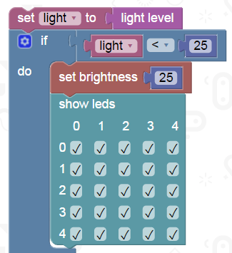

  • To tell the device how to do this, connect a [0] < [0] block next to 'if' and place a 'light' variable in the left-hand dialog box. In the first instance, set the right dialog box to 25, so that the code reads if [light] < [25].
  • For 'do' attach a 'set brightness' tile from the LED commands menu, and a 'show leds' tile from the Basic commands menu. Set the brightness to 25, and check all of the individual LED boxes on the 'show leds' tile, telling the device to light up at a very dim illumination when the detected light level is lower than 25.

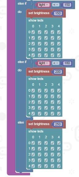

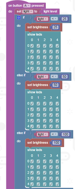

  • Duplicate all of these blocks for the four else/if options, and set the light levels to 50, 100, 150 and 180 respectively.
  • Set the brightness levels to 50, 100, 150 and 200 respectively.
  • Under the 'else' option, attach another 'set brightness' tile and set it to 250, telling the device to display the highest brightness when it detects any light intensity over 180.

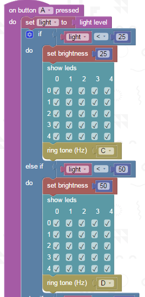

  • Finally, wrap your code in an 'on Button A pressed' tile to create a function that switches on the light sensor.
  • You now have a basic code that can should tell your BBC micro:bit to get brighter or darker depending on the light intensity. You can compile this right away and test it out on your device.
  • However, if you want to make things a little more interesting, you can also expand the code so that your device also emits a different note depending on the light intensity detected by the sensor.
  • To do this, simply add a 'ring tone (hz) [c]' tile for every brightness level, and set each to a different ascending note. (i.e. C, D. E. F. G, A)
