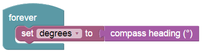

  • Begin by dragging in a 'forever' loop from the Basic commands menu on the left-hand side of the screen.
  • Connect a 'set [item] to' tile from the Variables menu, and rename the variable to 'Degrees' by clicking the dropdown.
  • Attach a 'compass heading (°)' tile from the Input menu.

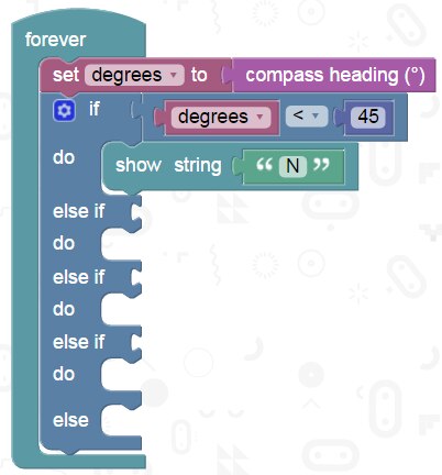

  • Now drag in an 'if/do' tile from the Logic menu, and attach to your loop.
  • For 'if' attach a [0] < [0] tile, and drag a 'degrees' variable tile into the left dialog box. Set the right dialog box to [45], so that the tile reads 'If [degrees] < [45]
  • For 'do' attach a 'show string' tile and set the dialog box to 'N' so that the LED will display the letter 'N' (for 'North') when the device is facing at an angle of less than 45 degrees.

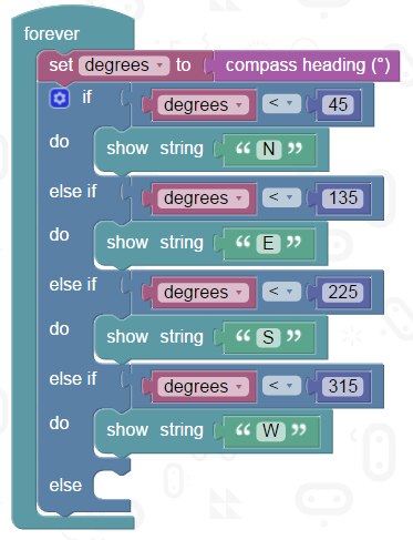

  • In the same 'if/do' tile, click the small blue cog icon to open up a pop up menu with some optional extra tiles. Drag in three 'else/if' tiles and one 'else' tile, so that your full block of code looks like this:
  • Using the same methodology, tell the device to read 'E' at angles of less than 135, 'S' at less than 225 degrees and 'W' at less than 315 degrees.
  • If the device is pointing at an angle greater than 315 degrees, it must be facing North. We don't need to specify the angles here - if none of the previous commands return as true, the bottom 'else' command will be enough to tell the BBC micro:bit to read 'N' by default if we tell it to.

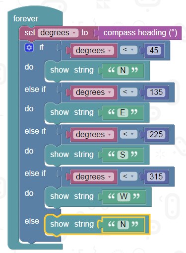

    I don't know much about programming BBC micro:bit and how this compass tile is implemented, but i think your program has the following flaw:
    pie slice corresponding to the north direction has only 45 degrees total (from 0 to 45 degrees), whereas pie slice corresponding to the west direction has 135 degrees total (from 225 to 360 degrees). Here is what i mean:
    I think you should change last else statment to else-if to define west direction only in the range from 225 deg to 315 deg and add another else to show string "N" as range from 315 to 360 degrees should correspond to the north too. Like this:

  • jlucas
    jlucas over 10 years ago in reply to kulky64
    Good spot kulky64, article amended accordingly.
