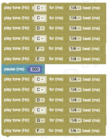

  • Click 'Music' in the left-hand command menu and select the tile that reads 'Play tone (Hz) [C] for (ms) [1] beat (ms)'. This tile tells your BBC micro:bit to play a specific note, for anything from 1/16 to a full beat.
  • Right click on this cool and select 'duplicate' to clone the tile. Repeat until you have six identical tiles. This saves you from dragging and dropping a new tile from the command menu for every individual note.

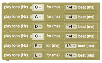

  • Attach the six tiles together, and change the notes until they form the first stanza of 'Happy Birthday', like so...
  • You may also want to change the '[1] beat (ms)' to [1/4] beat (ms) as indicated to speed up the song.
  • Add a 'pause' tile from the basic commands menu, and set it to 500 milliseconds.
  • Duplicate a further six 'play tone (Hz)...' tiles and connect them to the 'Pause' tile to create the second part of the song.
  • The notes for this stanza are: C, C, D, C, G, F

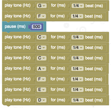

  • Add another 500 millisecond pause tile, then duplicate another seven 'Plat tone (Hz)...' tiles for the third part of the song.
  • The notes for this section should be: C, C, C, A, F, E, D.

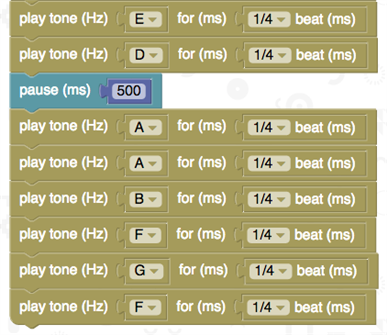

  • Add another 500 millisecond pause tile followed by six 'play tone (Hz)...' tiles for the final part of the song.
  • The last set of notes should be: A, A, B, F, G, F

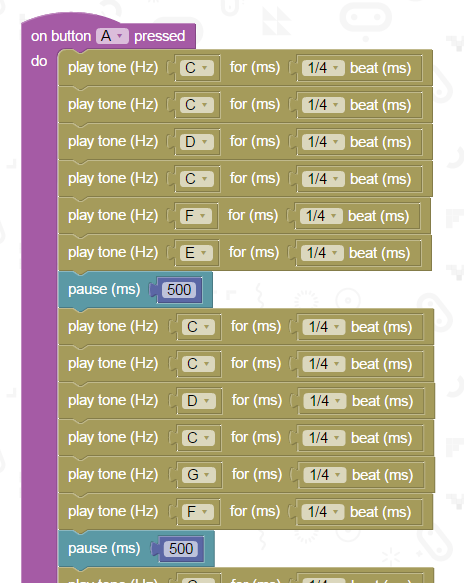

  • Before attaching the BBC micro:bit to the speaker, you might want to wrap your code in a function telling the device to only play the tune when button A is pressed, like so:
  • When you're satisfied, click 'compile' to download your script and transfer to your device.
