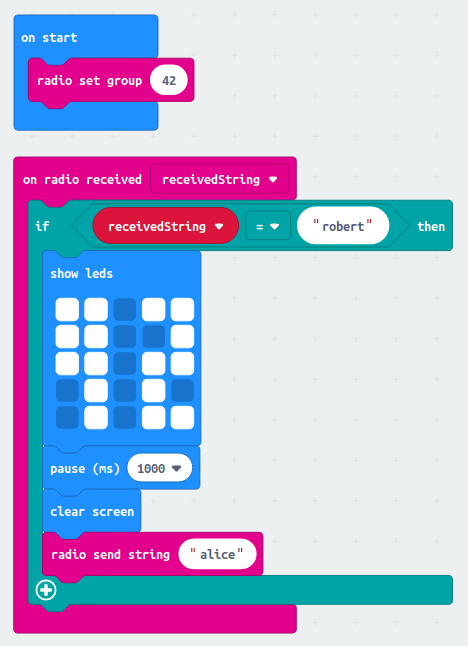

  1. Each micro:bit needs to be in the same radio group (e.g. 42)
  2. When a radio message is received that matches your name:
    1. Show an picture on the display (your choice)
    2. Wait for a second
    3. Clear the display
    4. Send a radio message with the name of the person on the left.

Project solution
Here is the solution for student Robert who is sitting to the right of Alice. Each student should have the same program with the names changed as appropriate.
In addition if Robert is instructing the class then you need to add the following to send the message when button A is pressed:
Common mistakes
Here are some common mistakes students make:
  • They have forgotten to join the radio group or are in the wrong group (not receiving anything).
  • The use the "on radio received receivedNumber" block - this looks very similar to the receivedString block.
  • They are checking against another variable instead of receivedString.
  • They clear the display immediately after setting it to their picture - need to add the pause in-between.
  • The picture isn't showing for long enough. Check the pause value was changed from the default 100ms to 1000ms.
  • They make a variable for the string values instead of using a text block. e.g. making a variable called "alice" instead of using the text block (which is unfortunately hidden under Advanced > Text).
  • The transmitter and received don't have matching names, normally due to:
    • One side using upper case and the other lower case. e.g. "Alice" and "alice"
    • One side having a space character after the name. e.g. "alice" and "alice "
    • The sending and receiving names being mixed up. e.g. "robert" and "alice"
  • They haven't downloaded the program correctly and the micro:bit is running older software (re-download to confirm).
