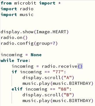

The advanced group conducted the same project but used Micro:Python for programming.  The programs for transmitter and receiver are:
Important points to note are:
  1. Use import radio to get all the functions required for radio link
  2. Radio on command and in radio.config  use group rather than channel
  3. Transmit and receive data is string “77” and “88” rather than numbers.
