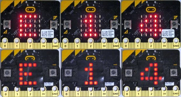

It is very hard to show accurately what the micro:bit display looks like with pictures or video because the LEDs are multiplexed, which means the LEDs that are apparently illuminated are not actually on at the same time. They are rapidly sequenced - too fast for the eye to follow, so it looks like many are on at the same time.
The camera is not fooled however and normally will only take a snap shot of what is actually on at the time and it will usually miss most of the illuminated LEDs.
This is especially bad when taking video of a scrolling display - the results can look pretty random.
In the following picture I set the camera to keep its shutter open long enough for all LEDs to be captured so you can get an idea of what it really looks like.
The top row of pictures are a normal micro:bit. The bottom row of pictures show the same "E14" display through the final diffuser assembly.
The fact that the LEDs don't appear to be completely red is because the camera pixels are over saturated from the intensity.
The pixel saturation from the the LEDs in the top row is so severe, it is bleeding into adjacent camera pixels, making the LEDs look bigger than they really are, so the top row of pictures look better in the picture than they do to the eye. Hopefully this comparison still provides some indication of how much better the display looks (to me).

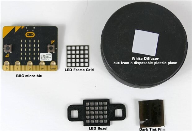

Below are the components that make up the diffusing bezel described in the video.
The whole bezel is 2 mm thick and simply snaps onto the tactile switches.
If you need the 3D STL files, let me know in the comments below.
I am still deciding whether to build the bezel into a full 3D case for the micro:bit.
The bezel and grid .STL files are attached.

    dougw over 6 years ago in reply to isdj68
    Okay - the bezel and grid .STL files are now attached in a .zip file.
    I am travelling for the first part of the week - I'll try to add it to the post when I get back.
