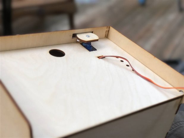

The box on the left of the door is the AAA battery pack for the MicroBit. The servo is mounted on the inside of the door, with the circle-with-a-side-chopped-off latch attached to a servo horn. Hidden in this view is a cutout to run the servo wires from the inside to the MicroBit, and mounting holes for bolts to run through the door and attach the MicroBit. The servo can be attached to power and `Pin 0` by soldering or looping under a mounting bolt. The MicroBit is on the outside of the LockBox so it can be configured, reset, and so the screen can display status messages.

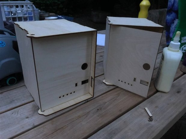

The parts were cut and packed, ready for our trip to Hornby Island and a session at a new Makerspace- the Hornby Island Spark.
The final assembly was done at a small cabin in the woods:
Very happy it went together with only one minor issue- the door should be slightly narrower to have a little more clearance so that it can be more easily opened and closed.
Note: the door is 1mm narrower in the latest version of the design on Autodesk's design sharing site.
